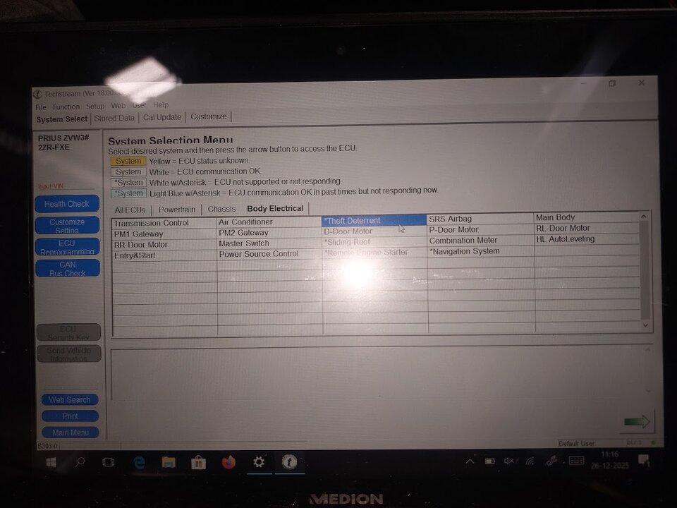

    I am in the proces of resurrecting an 2010 Prius. I am at the point that i don't have any more fault codes but the car still does not go to ready. I suspect that maybe one or more modules don't work. I had the same problem with the TCM. Does the inverter show up as part of the hybrid module or should it just show itself as a seperate module? I have added a picture of all the modules present. Also a picture of my dash. Hope someone can help me figure out why it won't start

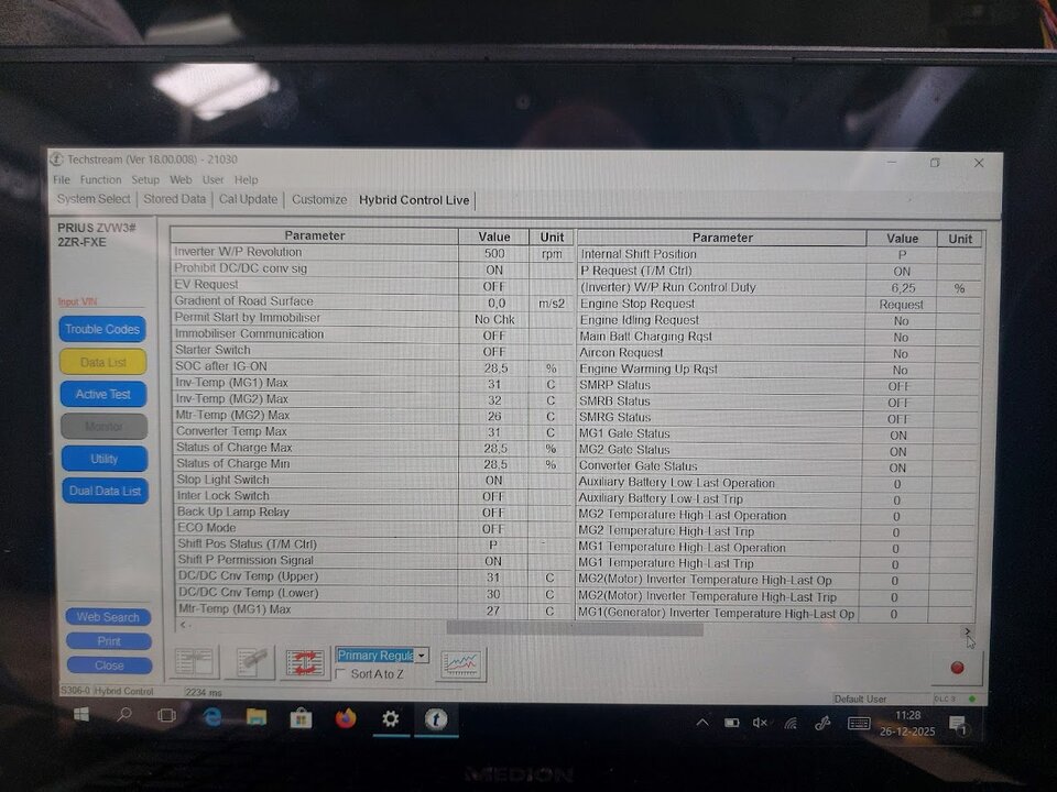

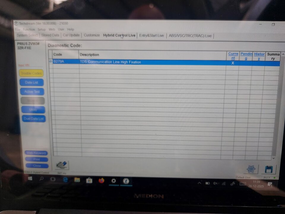

    With Techstream i found this fault code. Also found that the start permission is not being received. Also found that the theft deterrent module is not communicating.
    Any thoughts on where to find the solution?

    Just an update on this post. The car still does not start. Ready doesn't turn on. What i did was read all the data from the prius, prius-c and Lexus rx450h. Non have a specific theft deterrent system. The data that was different with the other 2 cars was that the s code, l code show NG and the master key "unset". On the other cars S and L code showed OK. Master key showed 'Match". So far i checked all the wiring and replaced the TCM and smart key module. I'm waiting for a complete set with ECU, TCM, PCM, SKM, Key, Push button and the module next to the PCM. Will give an update when i receive the items

    Took a while but the car starts now. I purchased a second hand set containing ; Ecu, TCM, Power management module, Network module, smart key module and key. It fired up right away. Thanks for the help. I didn't try to find out which module was at fault. I think it might have been the power management. I was afraid to start trying and messing things up.

    More than likely; it was one of those used modules you swapped-in. The issue I have with computer controlled modules; they can be programmed to only accept certain modules. A new or OEM rebuilt module will have a blank security key on the EEPROM. When the system sees this, it'll write a valid security key into that blank spot. If you put in a used unit, that would be an unrecognized security key and it may not function and the diagnostic software may not tell you - depending on your level of access rights within that diagnostic software.
    OEM's excuse for this is to prevent counterfeits and ensure a safe fully vetted product. This is simply control and prevents people like us from affordably repairing the product.
