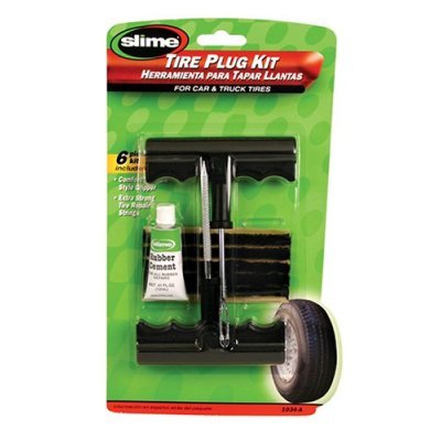

    I've kept one of these tire repair kits in each of our vehicles for years:
    They're inexpensive, available everywhere (including Walmart) super easy to use, easy to store and from my experience on two occasions- make an instant & permanent repair. Best thing- the PIP already comes with the inflation pump! I guess if I was going on a long out of state trip I might be tempted to haul a doughnut along, but for 99.9% of my driving I'll rely on the Tire Plug Kit. Once you've used the plug kit- you'll wonder why you never carried one before.
    FWIW- I keep a small set of needle-nose pliers (to help pull the sticky repair wick through the small hole in the tip of the insertion tool) and a small pair of diagonal cutters to cut the excess wick off if the puncture is on the tread surface rather than in-between treads. I also keep a few pairs of blue nitrile disposable gloves in the zip-loc bag with the repair kit and tools because the plug wick is very sticky and nasty- you really need to wear gloves while working with it!

    i thought the pump does not work without the goop?

    Yea, isn't the air hose on the goop bottle?
