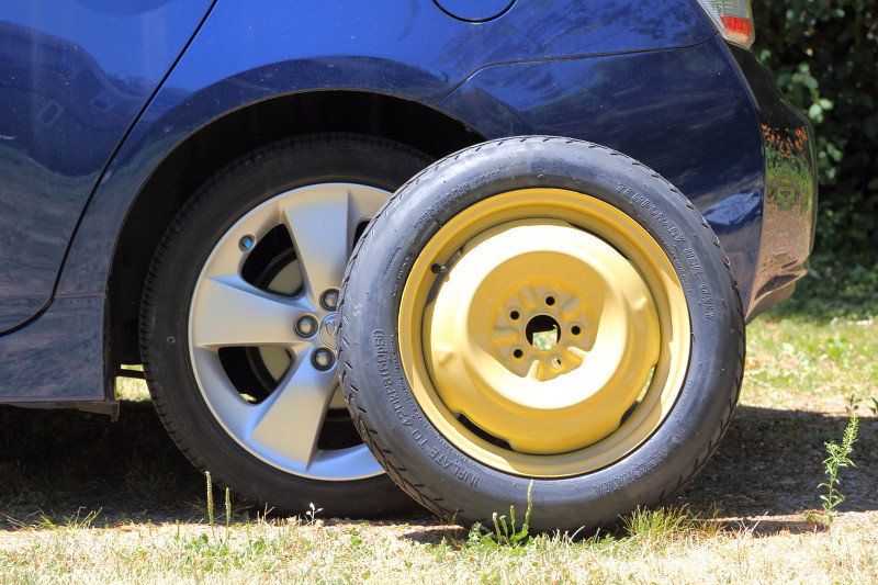

  3. I have experience with both size doughnuts, the smaller, Gen II is considerably smaller in height, that is diameter. So stay away from the Gen I and II spares. When you have the right size, you will see it matches your tires in height exactly . There is going to be a tremendous demand for these things so, move early.

    What's that you say? My Gen III's donut tire (and wheel) is far smaller then the real tires and wheels on the car.

    He's talking about the height of the tire. Yes, it is going to be narrower than the standard tire.

    Whoah. I'll have to admit, the two times I've been unfortunate enough to have to mount this space saver to my Prius, I felt as if I was listing to the one corner, so I had assumed it was a lot smaller in all dimensions. And when the car is jacked up and one is mounting it to the car, it really does look small. Now that I've had some time to take it out of the bay and place it next to the car, it is in fact the same height, or very close to the same circumference. I learned something today.
    Doesn't save much space after all, does it?
