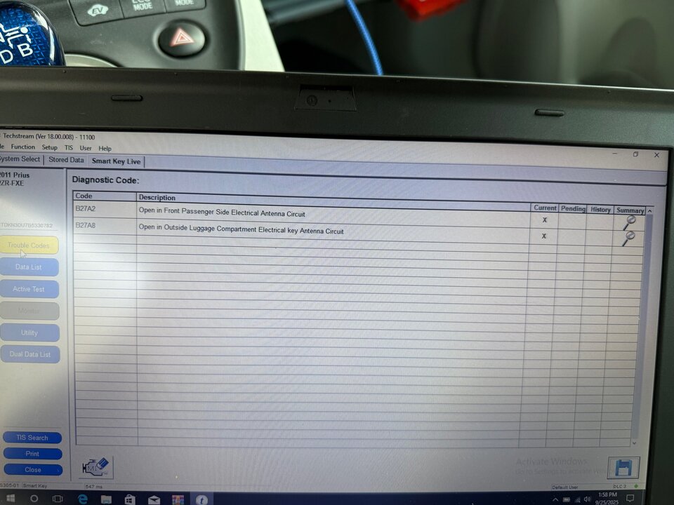

    Programmed the smart key ECU to the smart key. Each time I tried starting the car, I get only the dashboard lights on the dash, without the hybrid coming on.
    Scanned the car for codes, and got the following:
    B27a2 and B27a8.
    I have checked the passenger side door outside handle if there is a module or harness that were damaged, I couldn't even see anything.
    Trying to confirm the driver side door, I removed the door mat, to gain access to the sensor attached to the door handle internally. Driver side door has a sensor on the handle, whilst I can't see anything on passenger side outside door handle.
    The b27a2 keeps pointing that there is an open circuit between the smart ECU and the passenger side outside door antenna.
    Has anyone one across this, and how did you fix it? Isn't there a passenger side outside door antenna attached on the handle like I saw on the driver side in this model?

    So I further dug into the door harnesses of both doors, and realised that the driver side had it's door handle sensor installed, while the passenger side front door outside handle assembly sensor was none existent.
    It appears it was removed, before the vehicle was purchased from the USA, or something.
    That was obviously why I was getting the B27a2 fault code.
    I will buy another one, replace it, and see how it goes.
    Figs 1-2; shows the front passenger door handle sensor not connected. Obviously, that was the reasons for the open circuit fault between the smart ECU, and the sensor.
