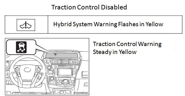

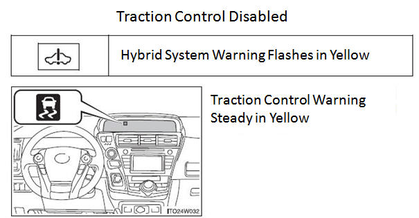

    You can turn off the traction control; however, it is convoluted to say the least. I tried it tonight on my Prius v and it worked. After trying it once, I shutdown and did it again in about 10 seconds.
    To disable traction control on the Prius:
    1. Parking Brake On
    2. Turn the car to ignition by pressing START twice without pressing the brake.
    3. Floor the gas pedal two times (two full top to bottom pressings)
    4. Make sure the parking brake is on, and while pressing the brake pedal put the car into NEUTRAL
    5. Again press the gas pedal two times
    6. Push PARK and press the gas pedal two more times
    7. Now put your foot on the BRAKE and press START one time while holding the brake down.
    #16 rjparker, Feb 17, 2015

    Convoluted doesn't begin to describe it. Or you could use proper winter tires...
