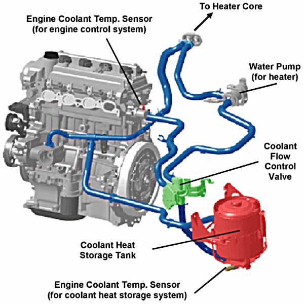

    There is about a 3 Quart 'thermos bottle' in the drivers side front bumper. When you turn off a warm Gen2, it fills that bottle so it stays warm, and reduces the warm up time next time you drive the car.

    Your Prius has an electric water pump. When you shut down the car, the pump moves coolant from the engine into an insulated tank to keep it warm. When you start the car, the pump moves the warm coolant back in. This helps three ways: the engine warms up faster, thus producing a little less pollution; the heater starts working sooner; and the engine doesn't have to run as long when you need cabin heat, thus improving fuel economy.
    The noise you hear after shutting down is the electric water pump.

    Per Water Pump Replacement | PriusChat, Gen 2 Prius actually has 4 water pumps.
