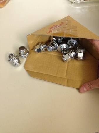

  11. Beachbummm
    Beachbummm Senior Member
    Sep 12, 2013
    1,160
    392
    I think his rims and lugs are off a gen 3 ..these are the lugs off a 2013 and they have washers [​IMG]
