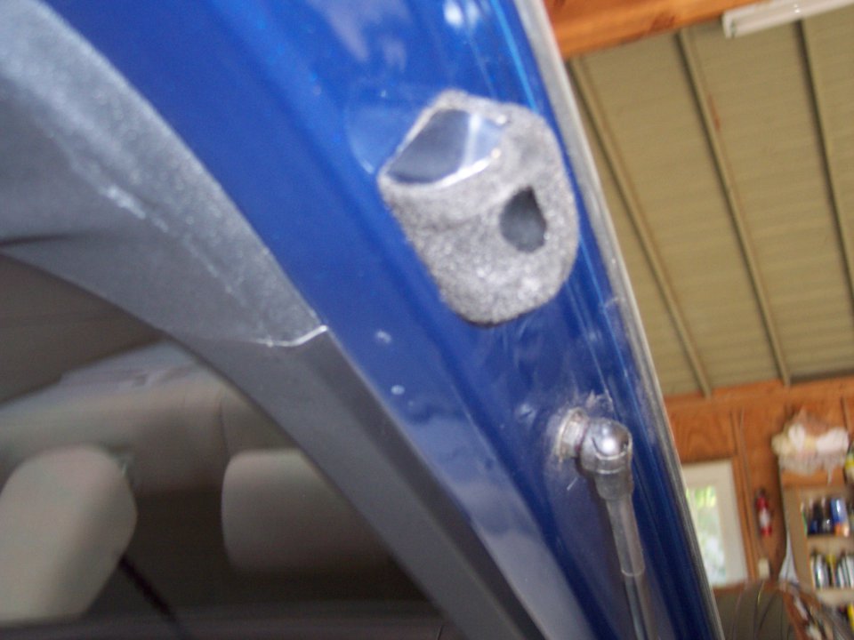

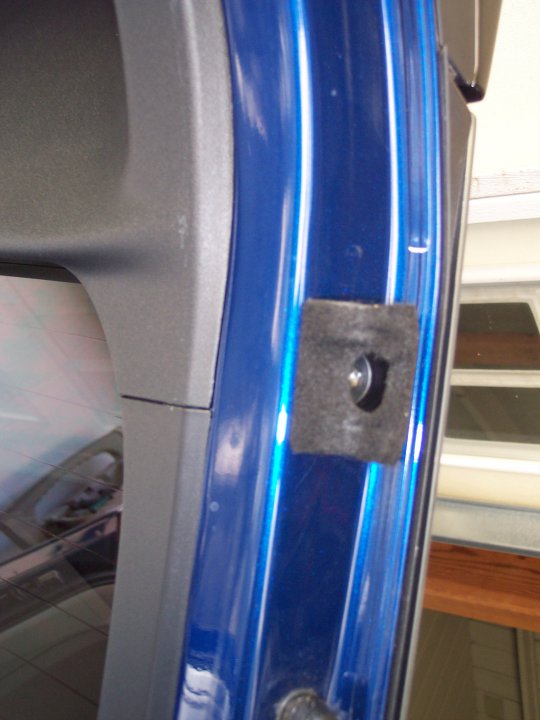

    Oh yes, your hatch noise could be caused by the rain spacers...I'd have thought Toyota would have solved that by now!! I used sticky-backed felt from Michaels to make covers for the spacers and that stopped my hatch noises.

    Phoenixgreg, thanks for the tip on the rain spacers. Funny thing, as I inspected my rain spacers and closed the hatchback, I noticed that the rattling sound came from my license plate frame. Since there are no screws on the bottom half on the license plate, that seems to be rattling on bumpy roads...
    I guess I'm going to have to look at another type of license plate frame. I did notice that the rain spacers still look like metal on metal contact, so I will add the felt tape just to play it safe - any noise reduction helps...!

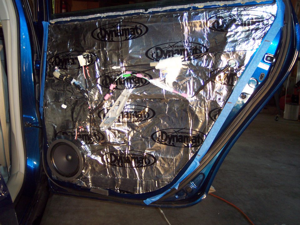

    I really can't say if $80 per door is fair or not - and it depends on how much material the shop really adds. Once the doors are back in place, you the customer won't know just what they did. I used Dynamat on all of my 4 doors too which make a big difference. Here's a shot of the passenger door exposed:

    I see that you covered the doors basically completely, didn't you aloud an opening for some humidity ventilation ?If not Dynamat name brand, there are other competitive products in the market with similar characteristics and end results.

    Humidity isn't too much of concern here, but I believe there is slot all along the top on the inside where humidity could escape. The biggest problem would be access to PDL and PWR window mechanisms, if they should ever fail. Then you or a tech would have to cut away the Dynamat to get at the device. I hope it never happens to me! I will say the sound-deadening is very noticeable and an added bonus is the improved performance of the OEM door speakers.
