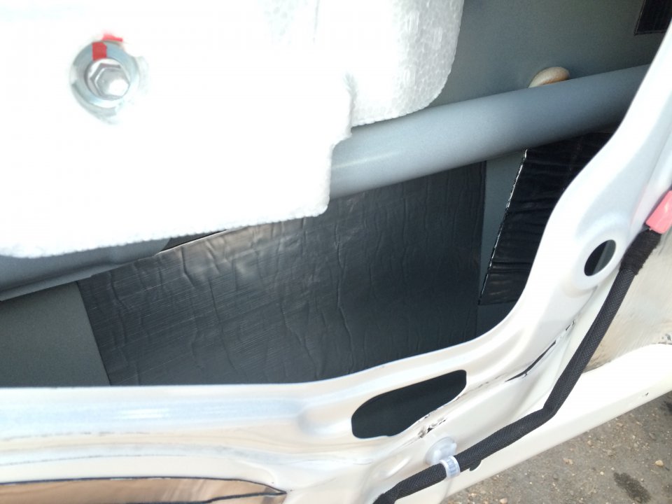

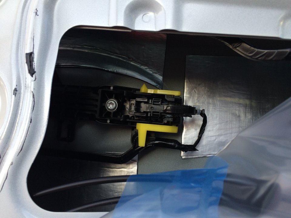

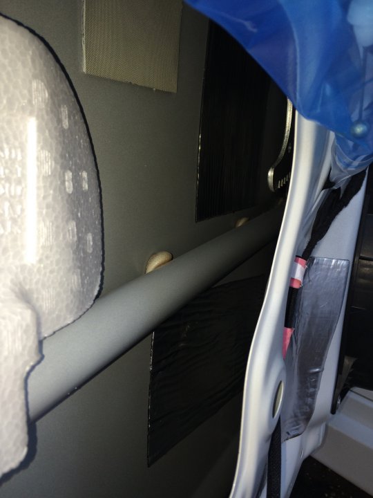

    I recently did some sound deadening on all my doors (including the hatch). Didn't do the entire outer panel(s) but applied the product in patches being selective due to cost constraints. Aside from improvements in music quality in the interior, another concern for me was the "tinny" doors so on the first image I applied two layers of sound deadener around the inner door handle wells and boy, I got what I wanted! My doors now sound like a luxury car in which I'm really proud and satisfied! ;)

    Thank you for your interest sthom. Just a little background... I'm no pro myself and was a bit hesitant at first but then since I only had limited financial resources but was eager to learn due to my curiosity, I jumped ahead and became a DIYer. YT was my main resource backed up by reseach through sites and forums I got self taught. Enough for the segway...
    Doing the doors wasn't dificult at all. I would say about 95+ of car doors are just a couple of screws and a few clips to take out. Now for the product(s) I used yes they are fairly thin in person but seem thicker in ads and videos. I combined mainly B-quiet Ultimate and Extreme and like a Peel and Seal waterproof membrane I got from Rona. The last product being the thinnest so I doubled that on some areas particularly away from the speaker and the former down and close to the speaker. By selectively(patches) I mean mainly due to finances so what I did was by feel, I tested the "bare" door by turning up some bassy music to determine the most vibrating areas. You can never "kill" the sound but only supress it to a certain level so patches was the way to go for me.
    I really hated the door sound so I thickened my patching on the handle wells, now my doors and hatch opens and closes like a luxury car, no more tinny doors! I've also done other area like the spare wheel, hatch, rear seat, rear quarter panels, and hood. Next step is I will be applying undercoating to wheel wells, undercarriage, and other "exposed" metal parts as this also helps to deaden noise.
    For noise as it now it stands, it's gone down an average 5-6db so a definite noise reduction already. I've also learned that if there's a 10db reduction it's like noise is cut in half so for me I have another 5db to work on! This will be concentrated on the exterior and firewall areas

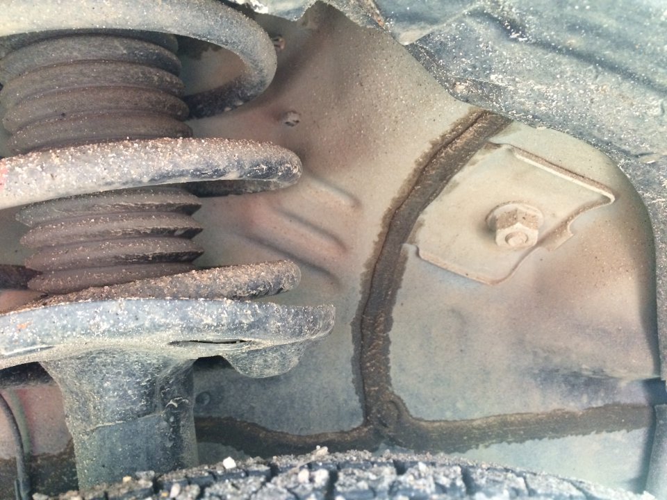

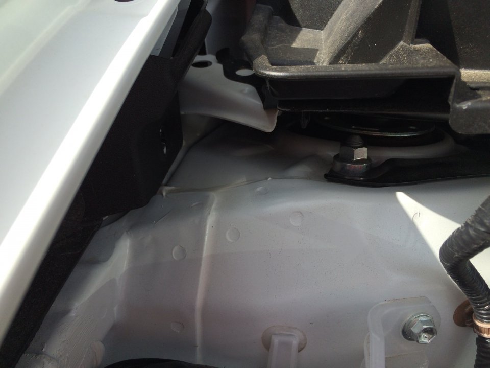

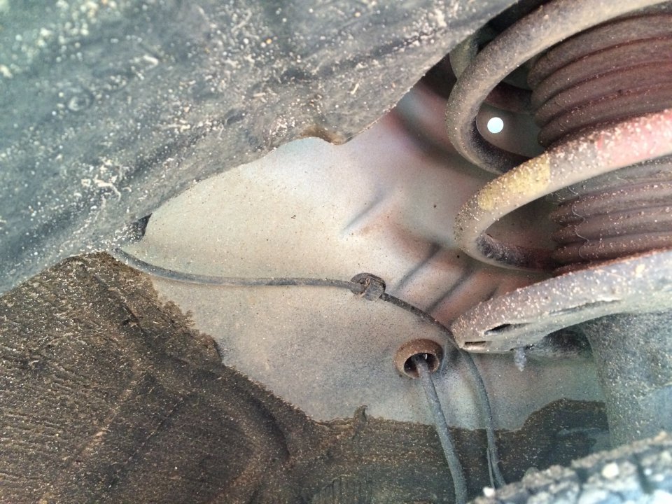

    Here're a couple areas I'm going to apply product(s) to. The first pic will get BQuiets and the wheel well will get a thick 1/4" coat of undercoating all around. I'm focussing more on the front cos when driving you can get a good sense of where the noise is coming from.

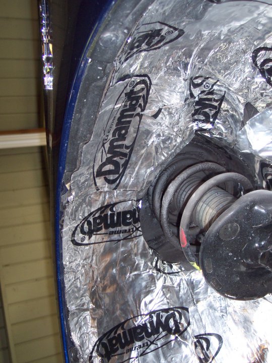

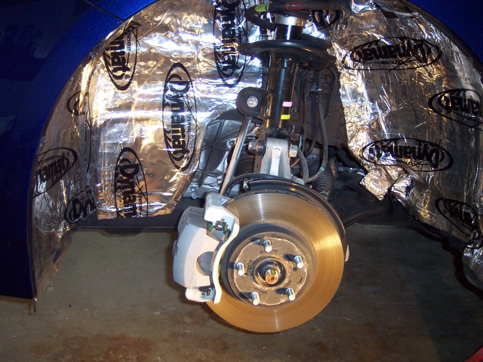

  20. phoenixgreg
    phoenixgreg Senior member
    Apr 7, 2010
    1,157
    295
    66
    Phoenix
    I did a similar project a few years ago:
    Dynamat wheel wells 003.JPG Dynamat wheel wells 002.JPG Dynamat wheel wells 001.JPG
