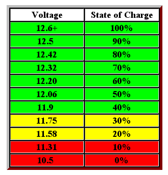

    I have to push back again on the premature statements that the battery is weak. My experience on two Gen3s is that these measurements are nearly 'normal' on relatively young batteries -- my 2010 in winter at two and a half years, and even my 2012 at one year, specifically this afternoon merely an hour after an errand run of two hours roundtrip.
    I don't have any mpg problems. The past cases of 12V-battery-related poor mpg were with much lower readings. At least one new reader was unnecessarily pushed to change the battery with similar readings, and it didn't fix her problem. And another reader posted this handy Prius 12V reference chart to another thread (sorry, I forget which):[​IMG]
    Note that this scale applies only to Prius and its 12V batteries. My non-hybrids fail to crank on battery voltages that are perfectly acceptable in the Prius.

    This table is incorrect as it relates to flooded lead acid batteries. Since the Prius 12V battery is AGM, 100% SOC corresponds to 12.9V. So as a rough index, add 0.3V to each row to determine AGM battery SOC. Further, I think that 0% SOC at 10.5V is too low, the voltage should be in the low 11V range.
