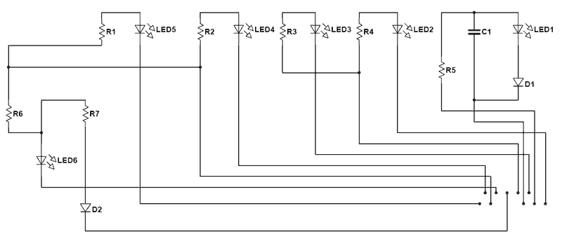

    Well I think I have a theory.
    The extra resistor and diode just pass voltage to a pin on the connector. Could this be an "enable LED" signal for the computer? Something like if signal is + then you have EV and light the LED when EV mode is activated, if not dont send voltage to the LED.
    Could this be how it works? If so we will need to find the resistor values to give it a try. Maybe if we can get one of our Japanese or Europe guys to take a good pic of the board it might help us a little.
    Here is a schematic so you can see what is going on.
    [attachmentid=7775]

    I'm fairly certain that the resistor diode combo is there to let the computer know that there is an EV light. I see no other purpose for it to be on this circuit board to be other than an indicator that "something" is installed.
    Here is what I would like to do if I ever decide to tackle this again.
    Solder the 3 wires back on the connector. Hook everything back up. Run the wires to a bread board. The bread board will have a simulated complete circuit that has say a ~250ohm resistor and LED, and a ~500ohm resistor and diode hooked together as shown in the schematic. Then test to see if the LED will light up when entering EV mode.
    Maybe someone that has all this stuff would be willing to try this out.
    Also what would help fully understand the resistor/diode combo would be if one of our Japanese or Europe friends could desolder the connector pad that these two components go to then hook everything back up and give it a try. I say desoldering the connector solder pad would be the easiest because its a big pad to solder so you really cant mess it up. Just desolder, test, then resolder. I would do it in a hart beat if I had access to a EV enabled Prius.

    <div class='quotetop'>QUOTE(theforce @ Apr 30 2007, 06:51 PM) [snapback]432852[/snapback]</div>
    Thanks for the pictures!
    I may be telling you what you already know, but the PCB is also missing the pull-up resistor for the LED, which means you won't get any change in signals measured at the point where the LED would go. Use a multimeter with continuity checker and see which resistor pad connects to which LED pad, then measure voltage between the other LED pad and the other resistor pad with EV mode on and off. My guess is that the system just grounds the LED when it wants to light it, so you won't see any change with just a voltmeter (other than going from floating to +12V.) Usually the ckt goes like this: GND--switch (ECU)--LED--pull-up resistor--+12V.
    Also, the values of those surface mount resistors are printed right on top. I believe the first 2 digits are significant and the last is a multiplier (check the Web for certain.) Worst case, you can use your multi meter across one of the others and measure its resistance.
