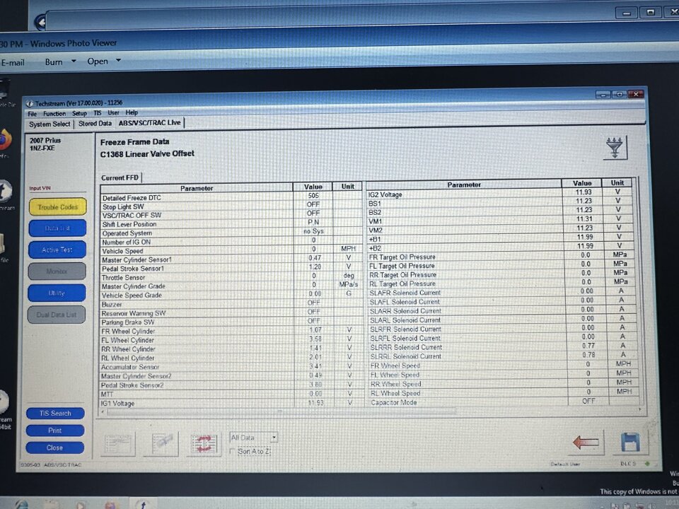

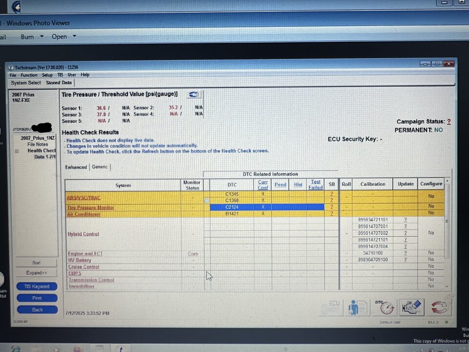

    So this is the TS codes, and zoom in detail ...
  8. ccna101

    So this is how it is...
    ABS made squeaky loud sound during trip return to town, less during travel 70mph down I-40. No ABS light, all clean.
    Cross AZ at 115F and yellow light for tire ... I pull off and check, all tires are good, continue.
    Once I am home: pull all tire off and start manual fluid brake change, start with RR then FL... then RL (issue-no drain) .. I stop here.
    I pop in TS (v17) and start under ECU/ABS : 1. clear memory, 2. Linear offset ...this is where it was NOT completed and failed. ABS and Warning Brake,plus Red Brake light are on... I can heard the ABS chatter at every 20 seconds or so after an engine ON - even with or without applying the brake.
    I can complete the manual bleed on all 4 sides now.
    Code C1345, C1368 on TS.
    I been pull the 12V battery off (+30 min) in hope of clearing / able to relearn the linear offset ... no luck.
    From the chart, it seem my RL wheel cylender are high, which is consistent of the -stuck- on fluild ? coincident ?
    I will pull all ABS wheel sensors and inpect now , just for kick of it ...
    --- I am running out of idea other than the ABS is not hold presure , and spit out codes.
    I am looking at a used unit in couple days .... darn .
