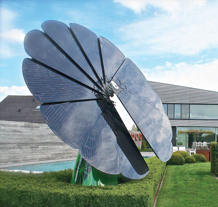

    The Smartflower is one of those nifty cool products out there.
    It is a self contained and self cleaning suntracking unit. The company claims the 2.5kW system is effectively 4kW compared to typical fix mounted systems. At $27k though. it is about $10k more than my 5.2kW roof system. Plus, I don't have the yard space for it. You can take it with you in the event of having to move.
    There are options to include 6kWh to 13kWh of battery storage. Where it would make sense for it seems limited to me, but the company also sells a unit for directly charging an EV.
    The Solar Flower You Need to Experience — SmartFlower
    SmartFlower Solar Review: The True Cost of a Solar Flower | Solar.com
    On other news, I got a letter from the township last week. Electric rates are going up 16% this year, and might increase further. Sucks, but my pay off sped up.

    ^ Nifty but yikes that's pricey, fully 3x what we paid per-watt.

    Aye. Can only see it being worth it if space for more traditional systems is lacking. Maybe for a business that wants an art piece to draw eyes. For that case, the EV model's cost might not be bad when compared to tearing up pavement and sidewalk.
