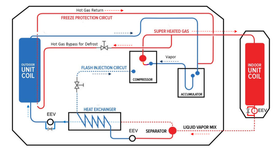

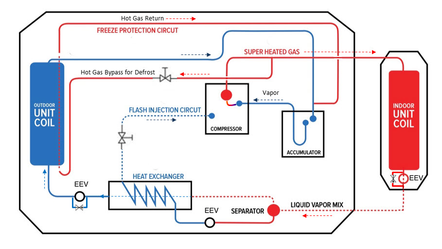

    Advanced heat pumps pioneered by Mitsubishi's hyper heat models can maintain their rated btus down to -20f and output some heat at even lower ambients.
    However how they do it is not in the brochures and the techniques are a combination of complexity and marketing trickery.
    The primary reason is variable speed compressors and blowers can run faster than "100%" to avoid losing "rated" capacity. The units get louder and use far more power at very low ambients. Efficiency can be worse than electric strips at extreme low temperatures.
    They also forego traditional reversing valve defrosts by switching to hot gas bypass which uses a separate refrigerant circuit to defrost the outside unit while still providing heat inside.
    Typical Hyper Heat Low Ambient Heat Pump in Heat Mode
    A "hyper" unit may be rated for 24,000 btus at standard conditions (usually 47f) but often can achieve that 47f capacity at 50% compressor speed. As the outside temperature decreases, the unit ramps up its compressor to maintain rated capacity. At some point the compressor is running at 100% speed and rated capacity and it gets colder outside. The hyper unit then goes overspeed (hyper) holding full capacity sometimes down to -15f. Typically the outside unit gets louder and actually is drawing far more current. The power use is opposite of a conventional unitary system that uses less power as it is getting colder outside.
    Hyper units have two more engineering features at their disposal. The use of electronic expansion valves (EEV) and computer controlled vapor injection. Some EEVs control the superheat and replace the function of traditional metering orifices (pistons) and TXVs (Thermal Expansion Valves). EEVs are computer controlled, stepper motor driven, refrigerant metering devices. The unit's computer can regulate the EEV to minimize wasted superheat and optimize the refrigerant flow based on realtime refrigerant and ambient temperatures. This adds btus and is needed for optimum variable capacity.
    Vapor (flash) injection adds another EEV and plate heat exchanger (HX) to divert a small quantity of refrigerant after it has gone through the indoor coil. It injects a precisely metered portion of flash gas back to the compressor to avoid excessive discharge temperature when the compressor is in its special "hyper" speed mode. Vapor injection easily enables at least 10% more capacity exactly when it is needed, eg during the critical below freezing temperatures down to the unit's minimum rated ambients.
    Finally, in most parts of the country propane is cost equivalent to electricity, so insulation and air sealing becomes more important to use heat pumps effectively. In order for heat pumps to effectively transfer heat to and from the outside air, proper installation is critical for long term reliability and more training and skill is required to repair a "hyper heat" model, something sorely lacking in today's tradesmen. Truck stock repairs are unlikely making dual fuel systems an optimum solution. With dual fuel the complexity of hyper heat models is unnecessary and tradesmen are more likely to be in their comfort zones.

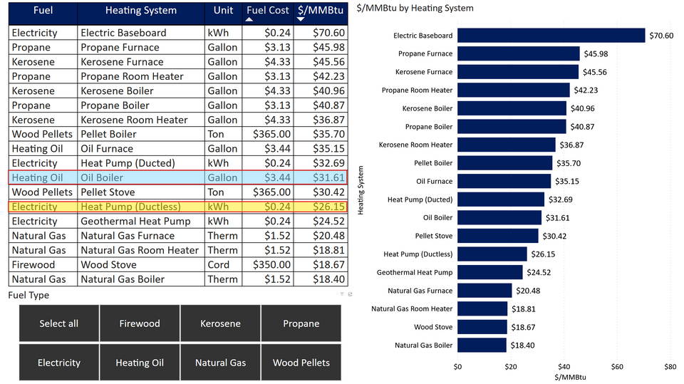

    Yep, there will be some learning curve adjusting to the use of heat pump as main heat source in our home. You have not missed much here, I have not been participating in PC much lately now we don't own Toyota in our household. We did not change the existing old oil boiler single zone hot water baseboard central heating system. I had a contractor give me an estimate to make this system retrofitting into multi-zone, but that turned out be prohibitory expensive. So, we left it intact. We had 5 mini-split units of high efficiency GE Endure heat pumps installed in spring this year to cover entire home.
    As you remember correctly, our existing heating system is a single zone and the thermostat is located in the central open area of gathering (open concept layout of kitchen/dining/living area) where we spend most of our time except when we sleep in individual bedrooms. This set up prevented the oil boiler heater and minisplit operating at the same time. If we use only minisplit in the "great room" only then oil boiler will shut off in rest of the home making other room unbearably cold. That's why I had to invest in whole home conversion with minisplit in every room. If we use the oil heat as main heat source in the "great room" then the minisplit in that room will not turn on. In this senario, we could use the oil heat set at the "great room" and use the minisplit as suplimental heat in other rooms, but I don't see the need for this. If the oil heat is on and the "great room" is set to comfortable level, then the rest of the house is also plenty warm without additional heat except in a few cold spots in some areas. So, it will be either oil heat or minisplit choice, not both. If the minisplit in real cold day turns out be inadequate to heat the room, then only supplemental heat available to us will be traditional resistive electric space heaters. And as you know very well, this is absolutely the most expensive way to heat due to our extremely expensive electric rate.
    And even if the heat pumps are physically capable of adequately heating our home throughout winter by itself, if the electric consumption of the heat pump bust our current Net-Zero balance sheet into red zone, and I have to pay the utility for kWh used, then our heat pump conversion is not working. The goal is to be stay Net-Zero (or minus) electric consumption by generating enough kWh from the rooftop solar and stay warm with emission free heating throughout winter. Our state put up table/chart below to encourage people to convert to heat pump and use electricity to heat our homes. It is depicting the heat pump as "cheaper" heating source than heating oi or propanel. However this calculation is based on the state average cost and the heat source operating at its maximum efficiency. I think it is misleading. We pay more than state average in electric rate in our town (currently at ~$0.32/kWh compared $0.24/kWh state average in the chart). My last purchase of the oil a few month ago was at $2.87/gal compared to $3.44/gal used by the state. And the electric heat pump would not be operating at 100% capacity in colder months.When I compared, BTU to BTU at our current electric rate and oil price and expected efficiency of the heat pump and oil burner, things were not as rosy as the chart below.
    Source: Heating Fuel Prices | Maine Department of Energy Resources

    Heat pumps work best as a heat source when set to a constant temperature as they are not great at recovery. Even though the most advanced vapor injection variable speed models produce rated heat at below freezing temperatures, they do so by increasing power consumption by going overspeed and require vapor injection to keep the compressors from overheating. The most advanced use hot gas bypass instead of conventional defrost.
