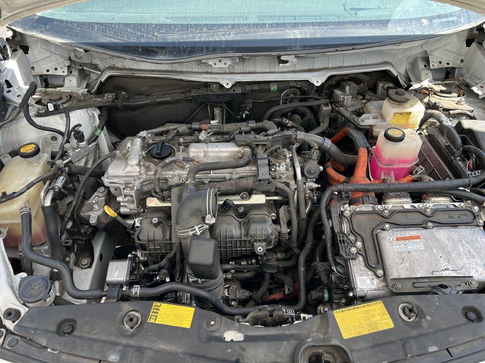

    @NutzAboutBolts will you also change the piston and rings? I don't remember if yours burn oil or not.
  2. NutzAboutBolts
    NutzAboutBolts Senior Member
    Mar 5, 2013
    1,693
    1,737
    Bay Area
    Might not… it’s my working car so I might just have the head resurface at a machine shop if it’s out of specs. Hopefully I caught the misfire in time before it caused a bent rod. So far there isn’t coolant in the oil because it didn’t look milky. So far I’m not half way there yet. Will resume tomorrow.

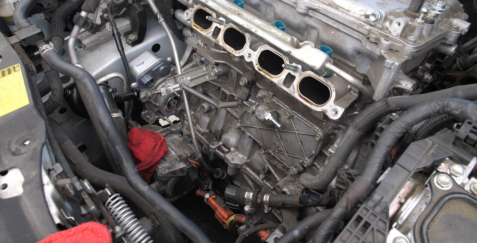

    Almost there, EGR was a PITA as always :ROFLMAO:.
    intake manifold looks dirty and gummy by the pvc area.
    still got a bunch of bolts and connectors to remove before removing the valve covers, and so on.
    johnHRP likes this.
