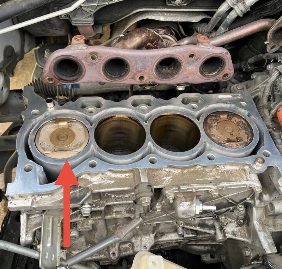

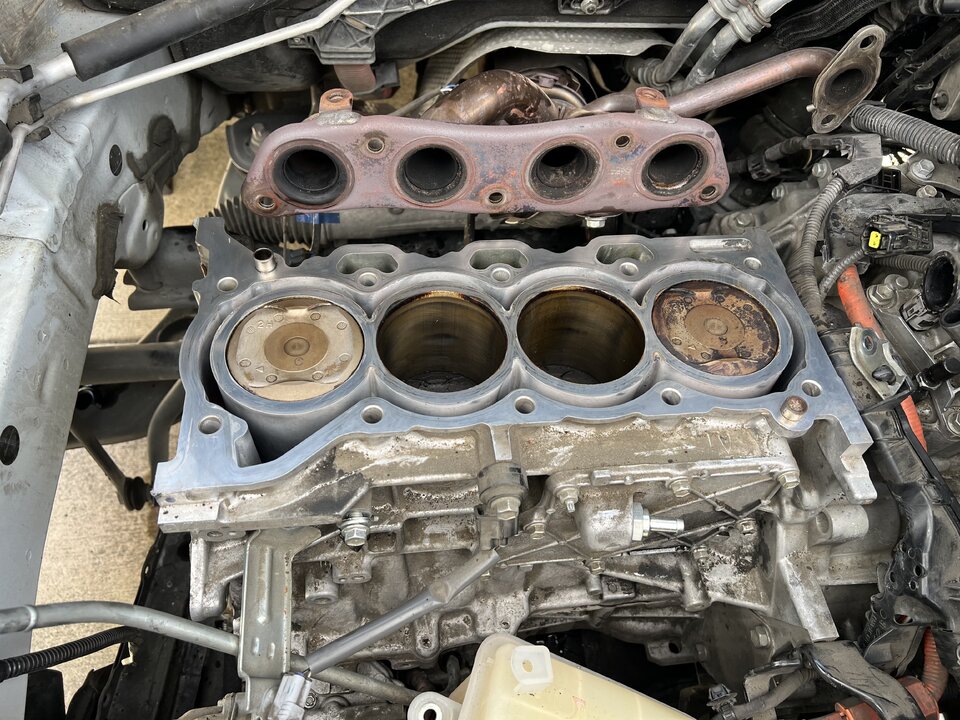

    I'm glad it wasn't too difficult to remove the broken spark plug..
    Are those cylinder walls are as bad as they look? Do they have uneven wear?

    Classic Steam Cleaned Piston

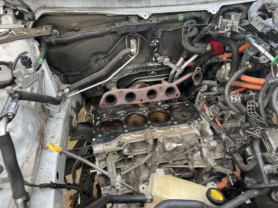

    cylinder walls on cylinder 2 and 3 looks normal wear. Didn’t see any bent rod on cylinder 1. Cylinder 1 and 4 looks even at TDC.
    the bad news is, all the machine shops are backed up 3-4 weeks, so I’m just gonna clean it up real good and reinstall :(

    :ROFLMAO::ROFLMAO: I know right? Lol I wiped it off clean with some brake clean on a rag. Cylinder 4 will take a bit of scraping to get the carbon off.

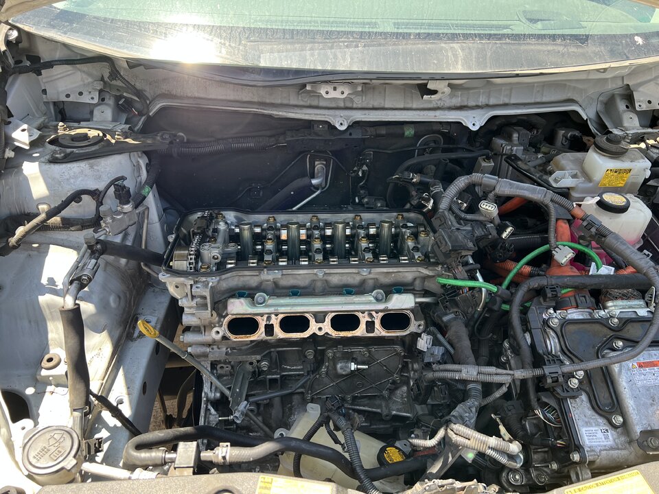

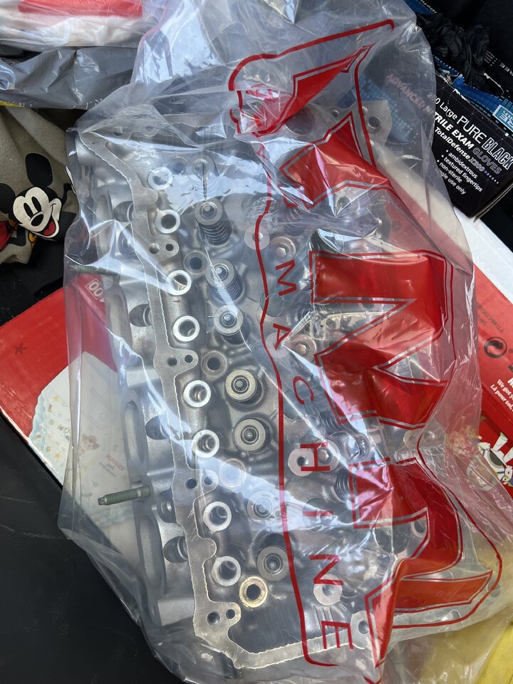

    Did you get a new head? Or remanufactured head? Or did you find someone else
    to do the work?

    I think it’s reman head, I just send in my old head and swap it with theirs. Same day since I live far from where they’re at, plus there was another Prius head there that someone else ordered as well. So this is a common issues with the 3rd gen Prius, it doesn’t matter what year, the headgasket will go.

    Do you know how much they shaved(if they did) to make sure it was flat?
    Hopefully, not much, cause there isn't much they can safely remove.

    he didn’t say anything about shaving, he just said they have a head ready that is cleaned for me to swap it out. He gets a lot of head order and head cleaning at his shop, so he has the head already there for anyone who wants to just swap it. I bet most people who fix these Prius, orders from him.
