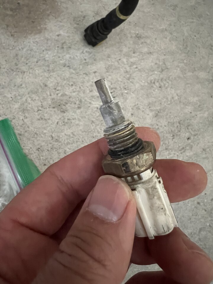

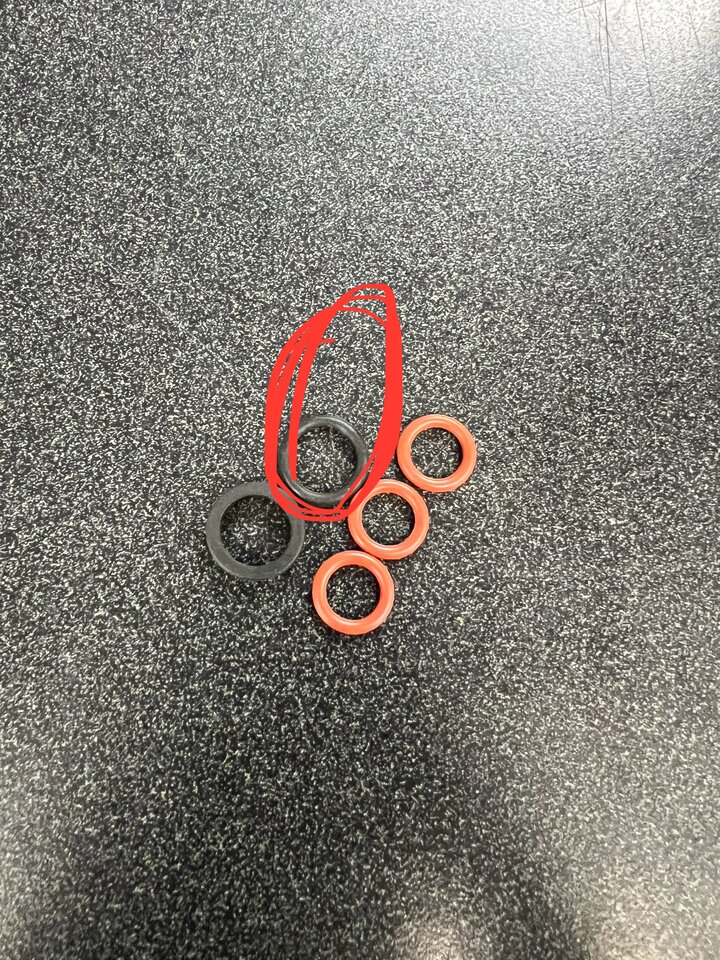

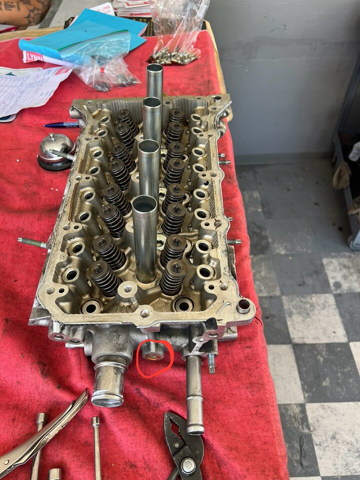

    So out of all the gasket and o-ring left, I’m stumped on where this o-ring goes.
    I think it may be the ECT sensor o-ring, but my old head has a welded gasket on the side, the new head doesn’t have a welded gasket sticking out, it’s flushed. So I assume this o-ring is for the ECT sensor, what do you guys think???
    EDIT: ok after checking, it might be it :ROFLMAO:

    Disregard that o-ring for the ect sensor, I believe that o-ring was for the oil dip stick tube. The ect sensor has a metal flat gasket on it. Gotta go to Toyota and get one tomorrow.
    edit: my old copper gasket was stuck onto the head. lol make sure you guys remove it if it is.

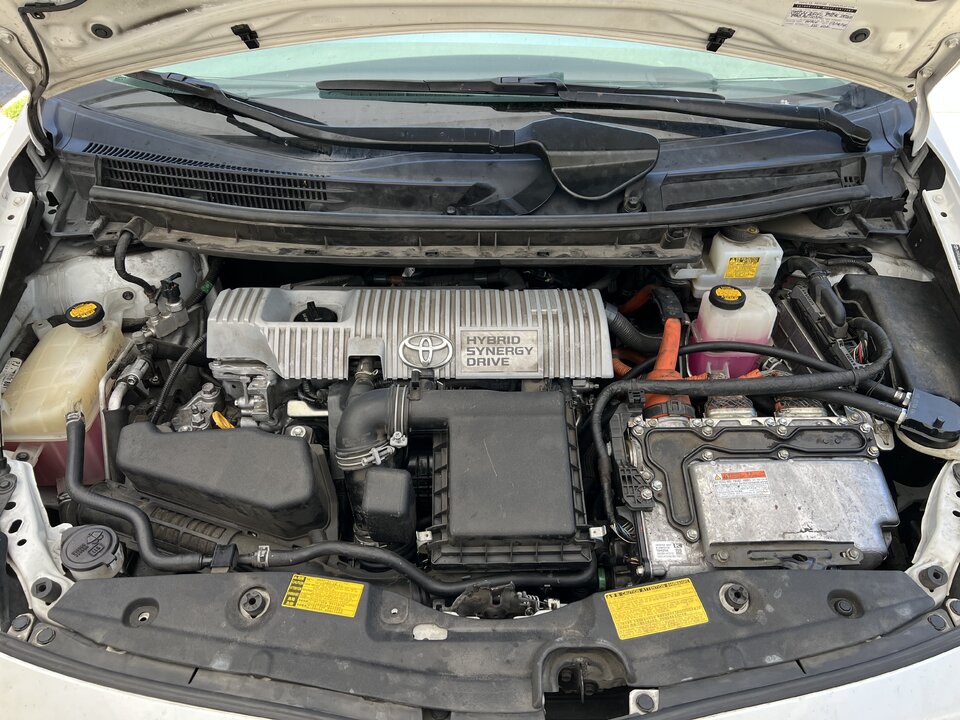

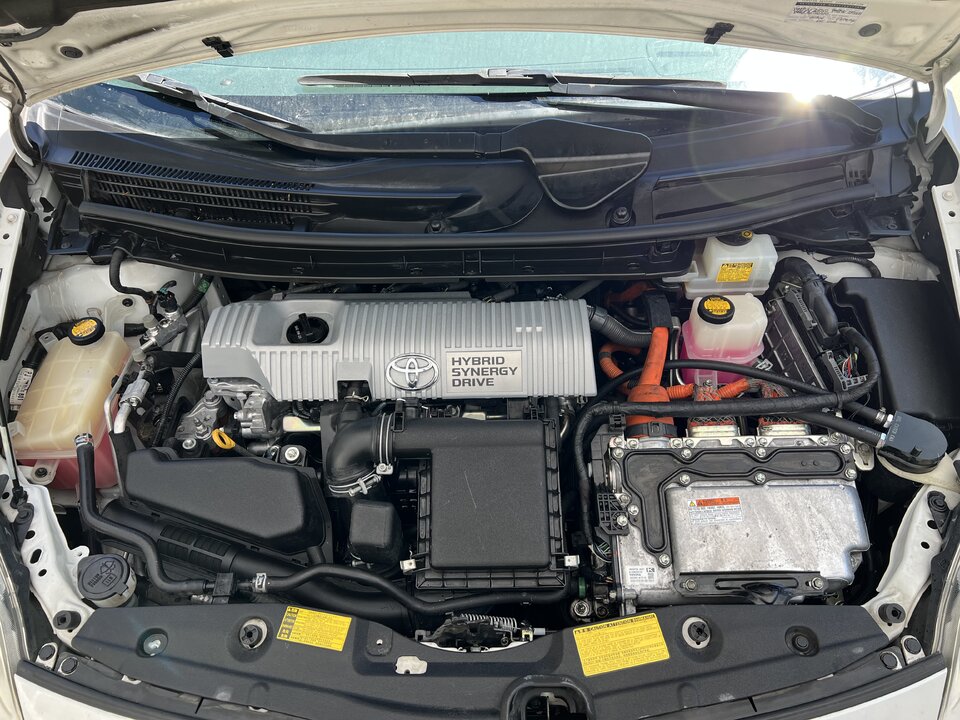

    Just purple power, pressure wash and 303 protectant the engine bay. :)

    Wow, you have "double catch can". One before PCV valve (buffle) and 1 after. Did the additional catch can reduce the carbon deposit in the intake ports?
    I just cleaned my intake manifold and EGR elbow pipe. The intake ports are a bit crusty at 112k miles.
