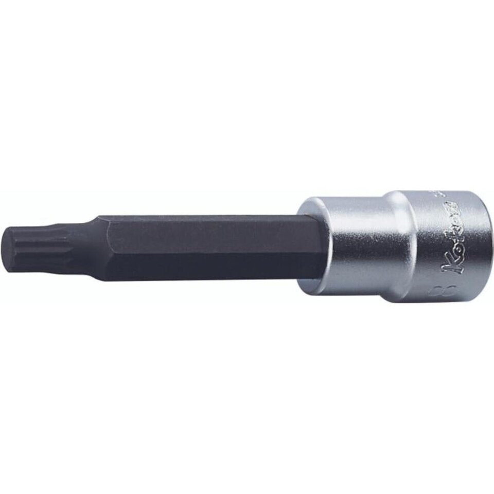

    The 12mm triple-square points are very slightly further out. Also, each point is 90 degrees (corner of a square) whereas with the 10 mm double hex the corners are 60 degrees (corner of hexagon). The latter just fits better, same shape as the head bolt pocket.

    Yeah, because of the different geometry, a 12 mm triple-square and a 10 mm double-hex are about the same size, and they both fit the head bolts. It's just that the Toyota head bolts are double-hex, so the double-hex bit fits them better.

    Mendel drew this picture six years ago or so. Magenta for triple-square, cyan for double-hex:
    Putting the triple-square driver in the double-hex bolt head kinda transfers torque only at the points of the square. The double-hex driver will have its faces flat against the bolt-head faces transferring torque.

    thanks, yeah I can see how different it can be. So far, I don’t have issues with it. It’s like a 6 point socket and a 12 point socket, which one gives better bite. All works the same, just better torque when tightening it down.

    @Mendel Leisk can you link this double hex for sale please, I can’t seem to find it. I can only find regular hex and triple square bits. I also looked at Tektons website and couldn’t find anything there either.
  12. Mendel Leisk
    60,254
    41,456
    Googling:
    10mm double hex
    I eventually got to this on Amazon.com
    An intermediate step, description found on Amazon Canada:
    CTA Tools 9292 10mm Head Bolt Wrench
    the manufacturer’s website page:
    CTA Tools - 9292 - Toyota Head Bolt Wrench - Double Hex - 10mm — CTA Manufacturing

    You might have to go to Snap on to get one.
    Toyota won't sell them to the public. Unless you know someone that works there that will
    get it for you.
  14. Mendel Leisk
    60,254
    41,456
    Snap-On has one too:
    Snap-on Store
    There's a caution in the "Features" paragraph, regarding the triple-square.
