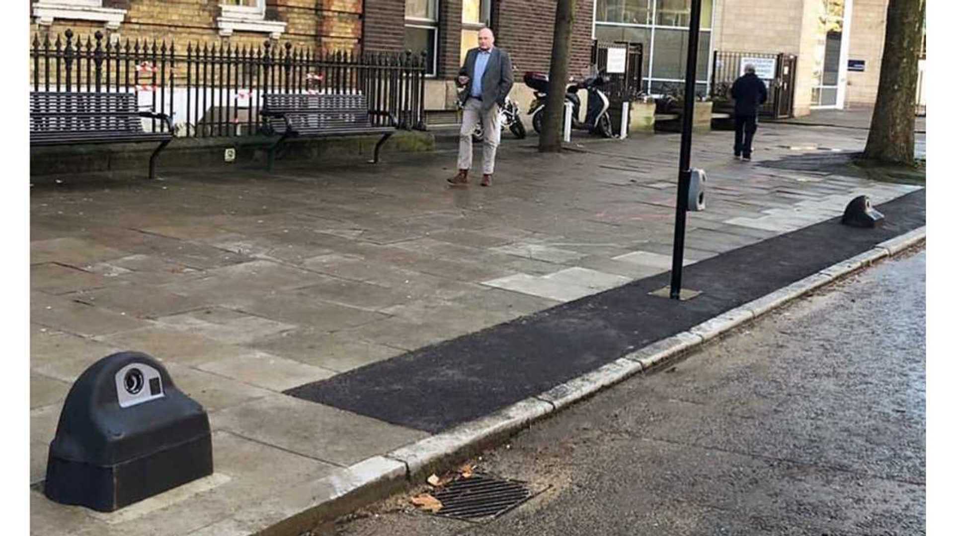

  5. Trollbait
    23,736
    12,822
    They are. While slightly more burden on the driver, it allows public chargers in locations where an attached cord could be a public trip hazard when not in use; EVSE's on lamp posts, parking meters or built right into the street curb.

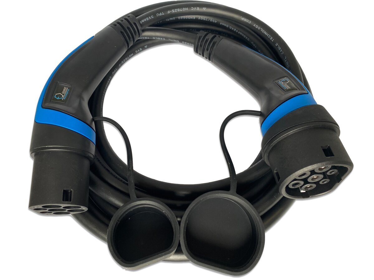

  11. Trollbait
    23,736
    12,822
    The chargers in town(don't know who), and Volta ones here don't appear to have a cord keeper.
    That's providing a 15 amp outlet so somebody can use their portable EVSE. In Europe, the car provides a cord to use a Level 2 public EVSE, which can be up to 22kW.
    Reduces the vandalism, theft, and tripping hazard risks since there is only a cord there when a charging car is present. Also opens up other EVSE options, that could make lower speed charging more accessible for those without home charging access.
