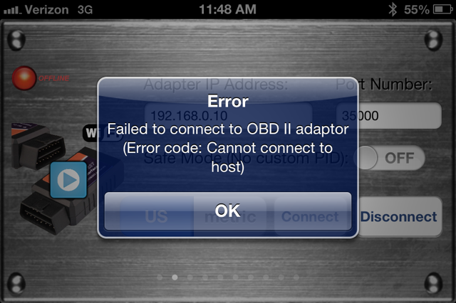

    I recently purchased an ELM 327 OBDII WIFI device and the EngineLink app via iTunes Store. Just to clarify what tech I am using, I have an iPhone 4s and 2012 Toyota Prius. I turn my car to the "on" position, just before the engine starts and I plugged in the device and configured the IP address and subnet mask on my iPhone with the IP address and port number within the EngineLink app. However, once I push "connect" this error message pops up and I am not able to do what I wanted to do... "Failed to connect to OBD II adapter (Error code: cannot connect to host)"----see image photo.PNG

    I had similar errors to start with. First time you try to connect I would suggest putting your phone into flight mode, then enabling wifi as it makes it more obvious that you have connected. (You won't normally need to do this)
    Don't use the IP address in the app, that is the address of your odbii. Try a different ip in the same range like 192.168.0.11.
