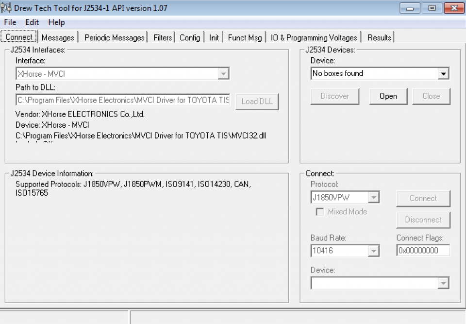

    I've usually grouped dongles into two giant categories: ELM327-based or workalikes, which most kinds of OBD phone apps and the like expect, anything that the phone or computer can talk to using the language of the ELM Electronics 327 chip, and then J2534 dongles, which are the kind Techstream expects, and usually more money.
    But it turns out things aren't quite that clear-cut. The J2534 standard isn't a hardware standard, it's a standard for functions in a Windows .DLL library that a program like Techstream can load, and how that library talks to the actual dongle can be any way it wants. If somebody builds a dongle out of clarinet reeds and Scotch tape and writes a J2534 DLL that works with it, then Techstream will see that as a J2534 dongle.
    That leads to something I didn't know (and haven't confirmed myself, but someone else here has posted it): the really common clone-of-XHorse-Mini-VCI that everybody talks about here is apparently ELM327-based inside. And the DLL that comes with it is essentially a J2534-to-ELM327 communication layer. And the person who reported that, also reported even using other ELM327-based dongles, with Techstream, using the DLL that came with the Mini VCI.
    That all falls waay out in the territory of "stuff I would never have learned because I'd have had way too much sense to try it", but I guess somebody has, and reportedly it worked.

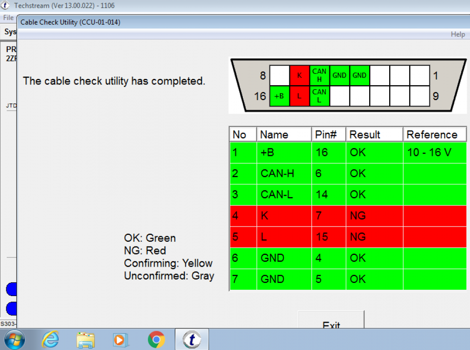

    That still doesn't mean every Techstream function will work, Different dongles still have hardware differences in which actual electrical wiggles they are able to put on which pins.
    Techstream comes with a screen where it will try to figure out which wiggles your dongle is capable of:
    There's also a free download from DrewTech to do the same in more detail:
    They're the outfit that makes the pricey Toyota-supported dongle, but that utility is free and will test whatever dongle you've got.
