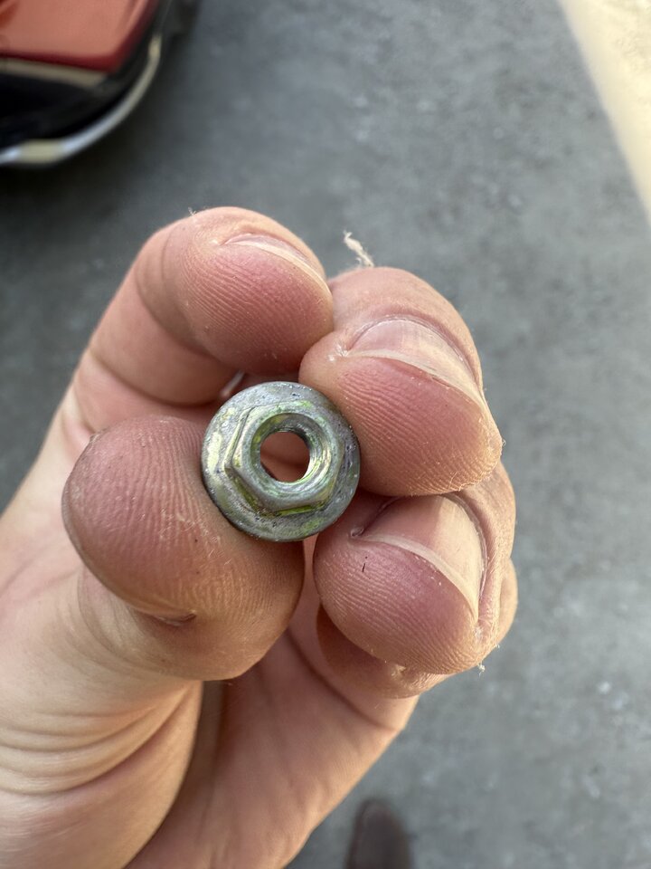

    So now I have a P3019 code. I have P3000 as well but that seems to just be a general code. The car starts and drives, but sometimes it has almost no acceleration and I don't think the electric motor is putting down any power at all. I will post some screen shots from Dr. Prius, but it says module 9 has a higher internal resistance although the voltage seemed roughly the same as the rest. I took everything apart around the hybrid battery to see if I could find a smoking gun, but the most I saw was some corrosion on the nut fixing the wiring harness to module 9 and some corrosion on the bus bar. (see pics). I cleaned the nut and stud up, hoping it would fix the issue and put it back together. Couldn't find the torque wrench, so I estimated the torque spec (48 in-lbs) by putting it to roughly the tightness and amount of threads showing as the nuts around it, which I did torque to spec several years ago.

    You need to replace the No. 2 frame wire. The Toyota part number is 82165-47040
    ACEN Bay sells an aftermarket part for this.
    The telltale sign is the impossible negative voltage on blocks 10 & 11.

    Negative block voltage readings on Dr Prius point to open circuit(s) somewhere in the voltage sense wiring. Might be at the module stud terminals. Might be at the ecu connector. Don't know if there could be an internal ecu fault that can give those readings.
    There might be other battery problems as well, but you have to fix the wiring first.

    Got it. So I’ll replace that. First I’m gonna try just retorquing the nuts because I didn’t use a torque wrench, but assuming that doesn’t work I’ll replace the wiring harness. I kinda figured that would be the case for the negative voltage thing. Do you think this could also fix the module 9 issues? Or is that likely to be something completely separate.
