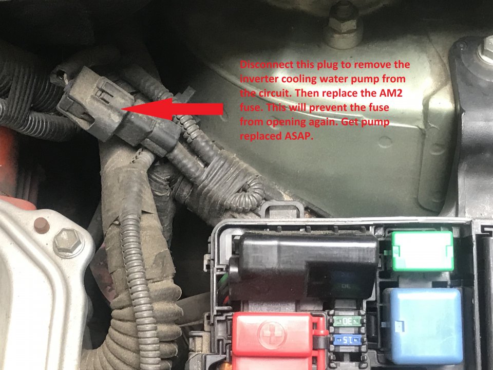

    Small update: upon further inspection, I think it's coming from the inverter pump. I touched the insulated tube and it's vibrating, maybe a bit harder than usual? Would this mean that the pump is failing possibly? Coolant level overflow seems fine and within levels, didn't need to open cap for turbulence since I can see liquid moving through the container.

    If it's the brake pump running continuously like that, after 5 minutes there'd have to be warning lights and a C1252 code.
    If you think it might be the inverter cooling pump, why not try unplugging that pump and see if the noise stops?

    Yup it was the pump as I suspected. I bought a replacement one with and I'll keep it with my extra fuses in my car until this one goes bad. Since its OEM I figured no point replacing it until it goes bust. Last time was a quick fix so I assume on the road wouldn't take to long either. Still wondering about the noise though, it seems mounted and sturdy but oh well.
