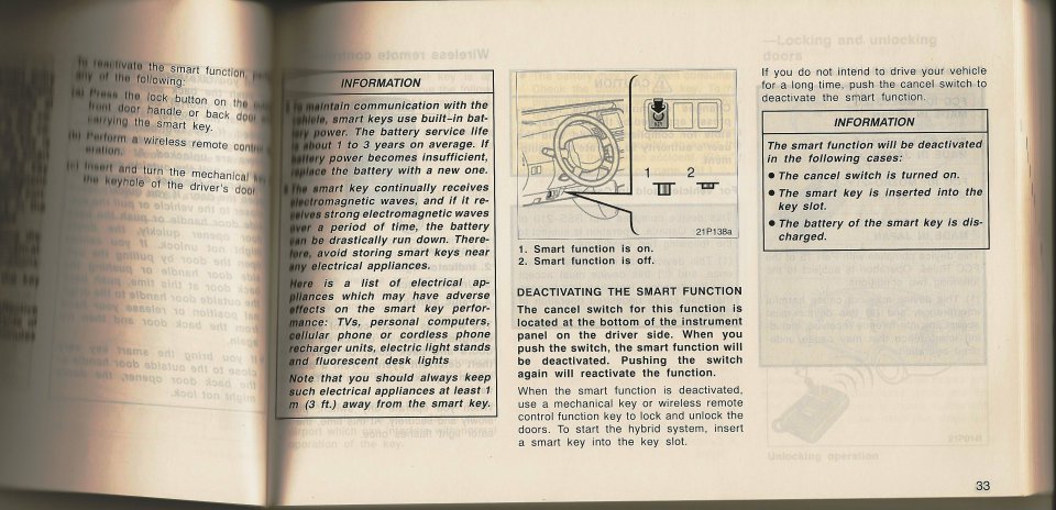

  5. jjmerp
    jjmerp Junior Member
    Oct 10, 2009
    51
    22
    Ohio
    When the FOB is inserted it Deactivates the SKS function. Push SKS button twice , turns off and back on. Page 33 of owners manual.
    SFO and jackmccullough like this.

    Operating the SKS button fixed the problem.
    Thanks, everybody!
