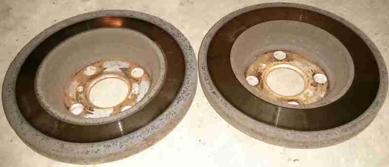

    While doing my left front wheel bearing I got a closer look at the brake rotor than ever before. Since buying the car 5½ years ago I've never done more than look at the visible disc surfaces and look through the calipers at the pad thickness, and the pads have stayed plenty thick even up to 210,000 miles.
    But taking the left front disc off, I noticed a strange wear pattern on the inboard side, where it was never easy to see. It's as if the pad has only been touching in a narrow path down the middle, with the inner and outer edges rough, rusty, and untouched. The inboard pad is still plenty thick, but worn into a stepped shape where the two concentric edges are missing more material than the middle. That made me want to take off the right disc too, which showed something of the same pattern, though not quite as bad:
    In trying to explain this to myself I run into a chicken-and-egg problem. I can definitely see how, if the discs had these rough rusty edges, they would chew up the pads at the edges and make the problem self-perpetuating. Or I can see how, if the pads had this step-shaped wear at the edges, they'd leave the disc edges to get rusty and rough, eventually enough to keep chewing the pads in the same pattern and make it self-perpetuating. What I don't see is how either one of those ifs got started without the other one. :confused:
    So, off went both discs to the shop for turning at the same time the bearing went for pressing. When the shop was done with them, they still have 36% of the wearable thickness remaining, not bad for 210,000 and probably good for a long time yet - if they don't start wearing this odd way again.

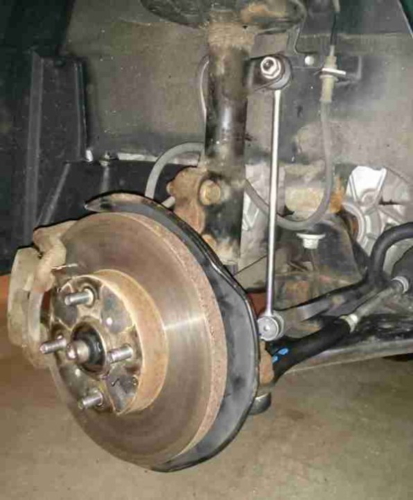

    In addition to new pads (04465-17140), I figured possibly something was binding with the springy "support plates" that hold the pad edges (sold as a "fit kit" 04947-47010, about $11), and also replaced all the shims (04945-20210), perhaps unnecessarily.
    I also noticed the rubber boots at the ends of the front suspension stabilizer links had cracked and started leaking grease, so now there are shiny flat rotors and shiny new stabilizer links along with the pads and springy bits. I'm sure I'm probably due for shocks too, but it can't all be in one week....

    On one hand, this is not unusual. Prius friction brakes don't get much use, the pads are not aggressive (you don't get the black brake dust that semi-metallic pads generate) and this vehicle has obviously been operated in a corrosive environment -- salted roads in Indiana? I would just do a diligent brake job, making sure that caliper pistons are not sticking. I would also inspect carefully for corroded brake lines!
    On the other hand, it's perplexing that the inboard surface of the rotor is the one affected. The piston is on the inside -- so if the sliding caliper is stuck, then the outside surface of the disk should show the most corrosion.

    Well, yes and no. Yes, let's say you've got nice rotors in good condition, smooth all the way across, and the car has been sitting in damp weather all night, and in the morning you drive away and notice a rough sound from the brakes, that will be light flash rust on the rotor surfaces, and you can wipe it right off by shifting to neutral and braking to a stop. No, you don't have to be cruising down the highway, and you don't have to "slam" on the brakes. All you have to do is shift to neutral and use them normally, like at the next stop sign on your neighborhood street. It doesn't have to be anything a passenger in your car would notice you doing differently, unless they happened to see you shift to neutral.
    But also no, if your rotors have already rusted to where they look like mine in the photo, that isn't flash rust that the pads can just wipe off. When it gets to that stage, it grinds away the pad surface instead of vice versa. So the pads aren't flat across anymore, and if you were to have the rotors resurfaced on a lathe but put them back with the same pads, the pads would only touch in that middle part, and the rings of rust would come right back, because the pads aren't touching there.
    So once it's like that, it can only be fixed by getting back to flat rotors and flat pads.
    Sticking caliper pistons would tend to cause brake drag and heat. Sucky mileage, shortened wheel bearing life, cooked rubber, but probably not rusty rotor surfaces. If anything, I'd expect them to be rather well polished.

    If you find the rotors starting to get rusty or pitted or shiny, but nothing deep, you can clean them right up with some 100 or 150 grit wetordry sandpaper, wet, using a pad as a sanding block, then turn the paper over, laying flat on the rotor, and rub the pad around on it to deglaze the pad surface. More serious measures like cutting on a lathe aren't needed unless the surface defects are worse than that. Those big gnarly rust rings, of course, do call for a lathe, or new rotors.

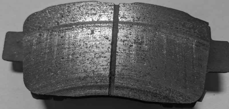

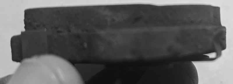

  12. ChapmanF
    28,649
    18,964
    What concerns me when things reach that stage is that the rust there is too well established for the pads to rub it away during braking. Instead, it eats the pads, from the edges toward the middle:
    Because it's possible to have Prius brake pads last a crazy long time, it can feel a bit embarrassing any time you end up having to replace them "early" because they were eaten by something correctable.
    Note in the upper photo that you can see the pad is being eaten from both the top and bottom edges.
    The bottom-edge contour isn't visible in the lower photo because its radius doesn't reach out to the side edges yet.
