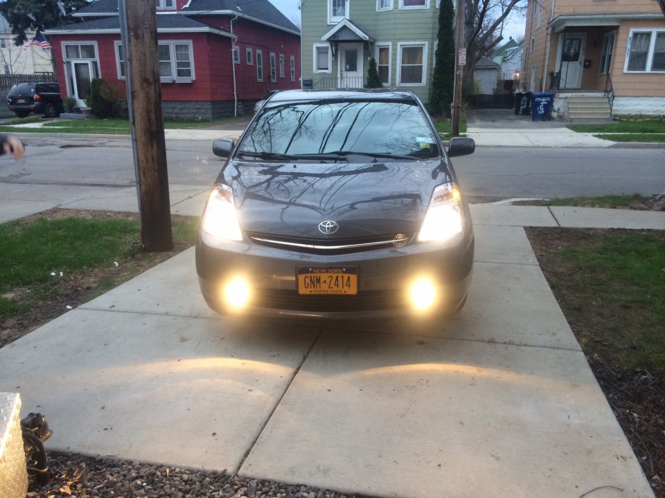

    I have a 08. Bought a oem fog light kit. Does anyone have any install instruction for this? The kit came with nothing but a switch, wiring, bulbs and trim pieces.. No instructions we're given. I searched and can't find anything.

    Finished today. Bought complete kit from ebay for 54.95. Complete with oem style switch, wiring and trim bezels. If you need help on the install message me

    Congrats, that looks great!

    Thank you sir. I'm definitely happy with it. Upgrading my headlights to HIDs. Contemplating the fogs too.. :)

    Where did you run the wire into the cabin for the switch?

    It's in the instructions. There is a rubber grommet near the brake pedal.

    Wiring is a bit different on the 2nd gen.
    I'm not sure where to pull 12v under the hood. Is it a bad idea to use the jump terminal?

    you can get 12 from the big terminal in the fuse box on the driver's side under the hood. but then you'd need to be careful not to leave your fogs on all night and kill the battery. might be a switched terminal in the fuse box too.
