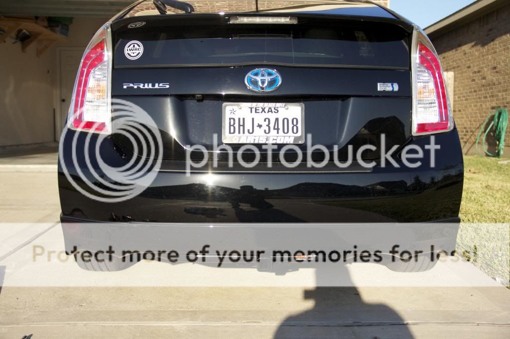

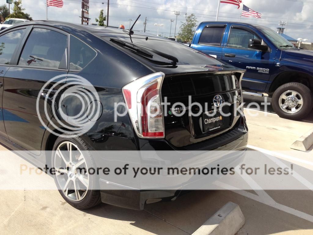

    i have a tss prius that came with ground effects. I dont have a hitch but I am thinking it will be a problem.
    I will post pic in a minute

    here is my pic

    jaymac. I think you are correct. I cannot even see my exhaust tailpipe from the rear on my car with the ground effects kit

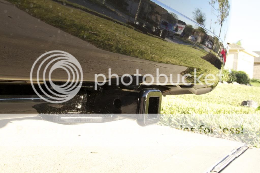

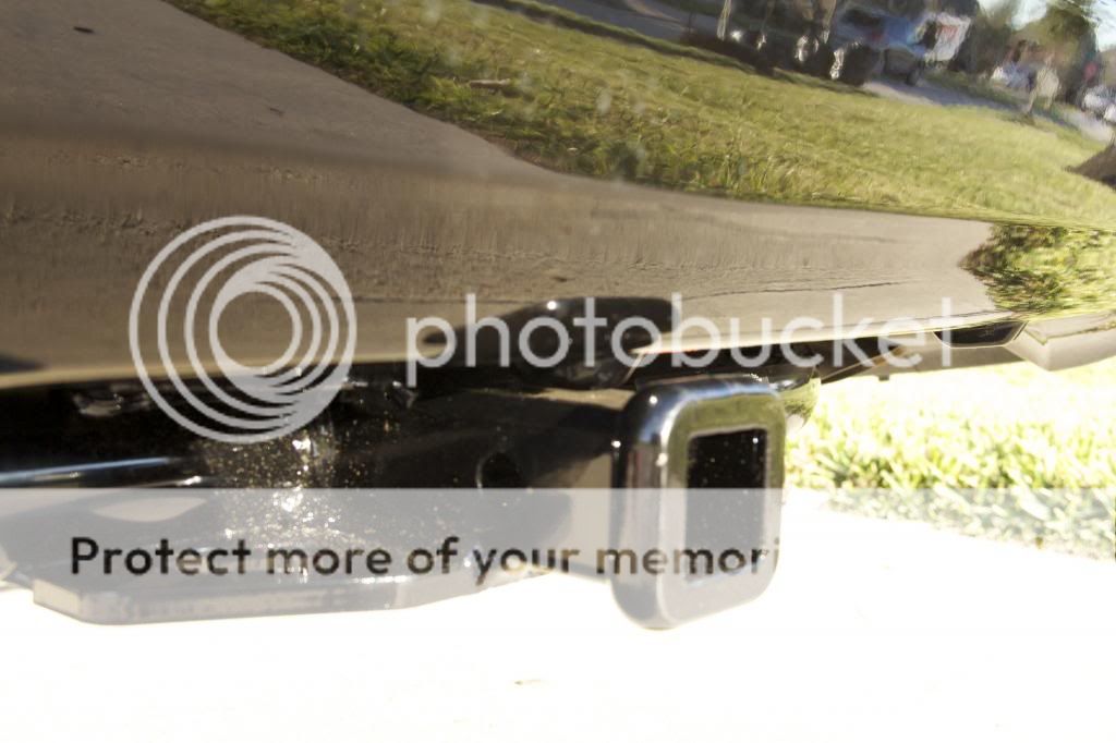

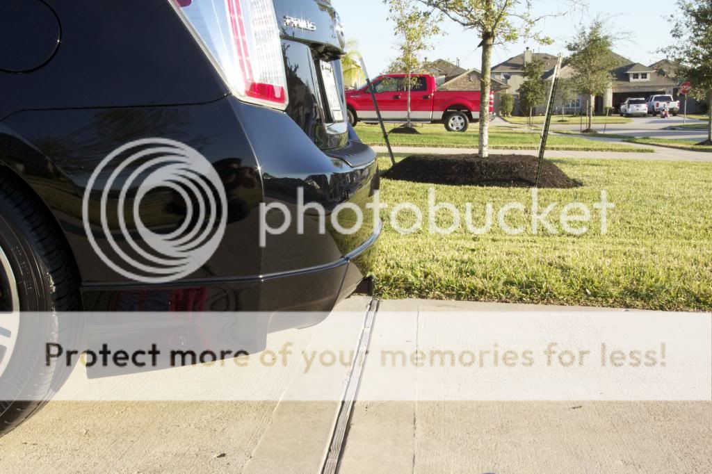

    did any of my pics help? here is a better pic from today

    It did thanks.....looks like 1-2inch of a difference.

    my curt hitch Curt 112760 worked.
    i think because the curt hitch is not as low profile it really allows room for a car with the ground effects.
