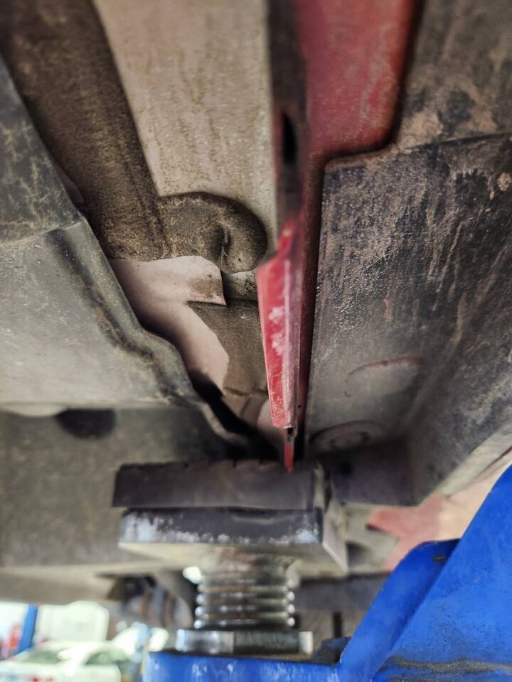

    That additional red downward fil meant that your jackpoint is modified to fit the top of the slotted standard Toyota-Lexus jack, not the smooth top one.

    I've seen two different jack designs, but I haven't seen the allegedly different TNGA car design yet. All I've seen clearly are the curved fins like that red one, which is the same as my G5 (apart from colour...)
    The two you're saying are different I can't make out well enough to say they're different or not. One pic from the other thread looks the same to me, and the other pic seems to have missed the point altogether. Can you manage a clearer pic to show the alleged difference?

    I've seen the vertical fin (as on G2) and the folded fin (as on G5).
    What I haven't seen is the non-fin "smooth rounded section" "early TNGA" jack point that @Georgina Rudkus thinks the flat-top scissor jack is intended for.

    I tend to agree with GR this is the more appropriate jack for that curved fin jack point. This was the jack style from my wife's Elantra I used remove my LTD flat the other day. It fit perfectly.
