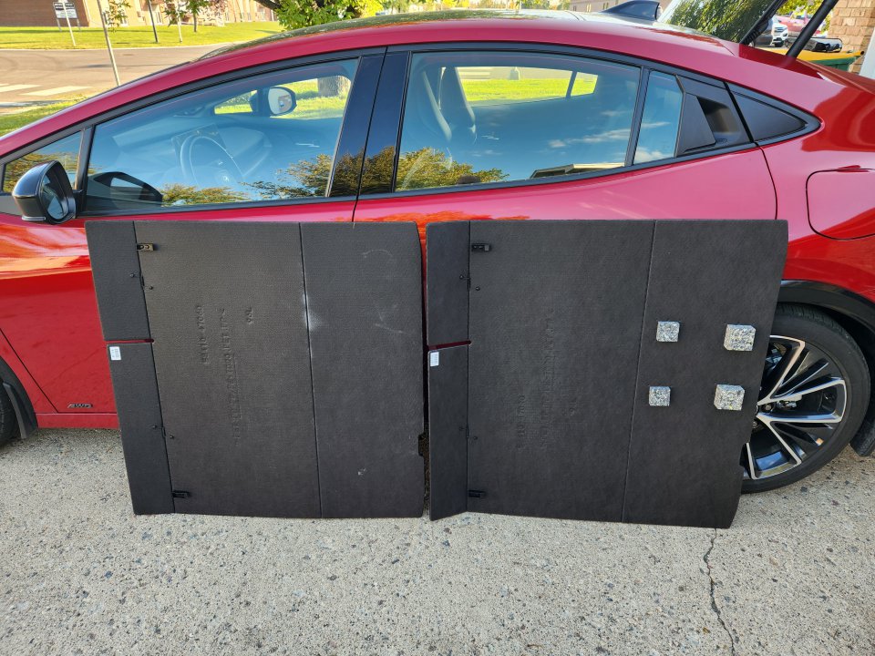

    One more question: Is the only difference under the deck of the hatch between the AWD and FWD versions of the XLE the presence of the exposed charging cable in the case of the AWD? If someone converted their FWD XLE and happened to take a picture with everything out, I'd appreciate seeing it. Otherwise, I'll wait for another warm day and take mine out to see. Thanks!

    It's a bit of overkill. Here's a photo of the OEM boards side by side. The one on the left is the one that comes standard in the XLE & LTD in the US, while the one on the right is the one that comes in cars with the spare tire. The only difference is the four blocks of foam/rubber.
    The larger blocks of foam are roughly 2.3"x2.3"x1.25".
    The smaller blocks are roughly 2.0"x2.0"x0.75".
    They seem to be made out of fairly dense, compressed, recycled rubber.
    I took some photos of the blocks to get placement dimensions, but they turned out like crap. RobotBastard did a much better job with their pics at the top of page 19 in this thread.

    Thanks so much! This looks more practical. I’ll take a look at RobotBastard’s post.

    2023 and 2024 are the same. From what I understand the only difference with FWD and AWD is the AWD has some components below the cargo area but thankfully they don’t interfere with adding the spare.
    I would suggest using the YouTube video that’s posted
    several posts above this one. The video addresses the required parts. A few people have saved money by cutting the original styrofoam to fit the spare instead of buying the new OEM foam pieces. Sounds too messy for me.
