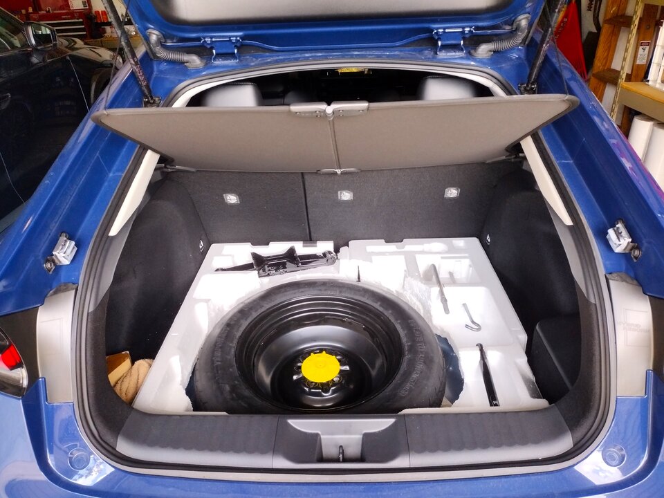

    Here's what I did. Just used what i had and cut it to fit the tire in. Going to get the bolt down to hold it in place, and I have the Cabling protected under the spare as well. I'm not spending $400+ for some Styrofoam inserts.

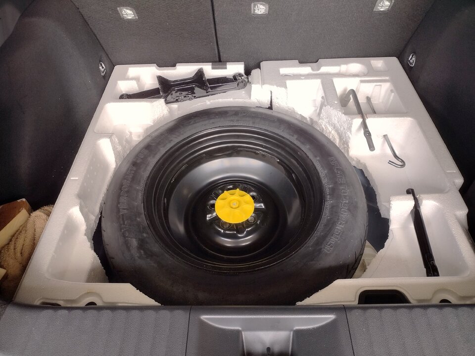

    With the help of all the info posted in this thread, I did this install a week or two ago in my new (to me) 2024 LTD AWD. I ordered all the parts from Lewis Toyota who had a decent discount from MSRP and free shipping. The tire I ordered from Tire Rack online and that shipped for free as well. All that arrived in a week or so from ordering.
    - Carrier, Spare Wheel, Right Hand - #51931-10040 - $13.49
    - Protector, Spare Wheel - #64778-47090 - $154.09
    - Protector, Spare Wheel Carrier - #51978-47010 - $35.88
    - Flange Nut x3 - #90178-A0132 - $3.18
    - Disc Wheel - #42611-21280 - $78.65
    - Hub Nut Box Wrench - #09150-42010 - $41.00
    For a total of $326.29. Adding in the tire brought it to $423.86.
    I didn’t want to spend the extra on the styrofoam boxes so I carved my existing ones without too much difficulty. I already had a spare jack from an old Hyundai that happened to fit so I saved a bit on that too. Also, shout out to Discount Tire who didn’t bother to charge me to put the tire on the wheel.
    The deck board felt a little unsupported in the middle where the tire didn’t quite come up to the height of the styrofoam, so I took an old towel and folded it up on top of the tire to add that little extra support. With a little creative carving, I was able to fit all the tools and pump back into the styrofoam boxes in a way that felt secure.
    Overall I was happy with the balance of saving some money and keeping it relatively easy to do. Thanks again to everyone who has provided such great info on here!
