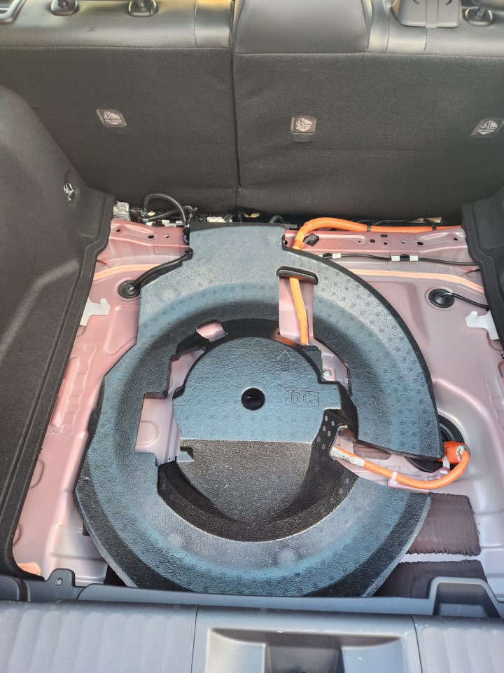

    Prius LE spare tire reporting back:
    Overall, I would say the LE spare tire install was a success with minor caveats as Hammersmith has pointed out and a few updates as well:
    1. The LE has a different configuration for the the plastic trim that forms on the bottom of the hatch opening and where the deck floor boxes latch onto. Since the LE has a lower floor, those latching points are lower than in an XLE or Limited trim. The black plastic clips DO NOT reach down far enough. The left hand side foam fit is not great on the LE and there is play on the left side foam. Right side foam is snug and secure enough not to matter too much. However, the latching points are too far apart to reach for both foams on the LE trim. The foams are not as sturdy as I would prefer. However, the LE fit is snug enough with the spare tire installed to still function.
    2. The existing deck board is good for the LE. There may be minor dimension tolerances but its close enough. However, the carpet mat has wing extensions and there are loose flaps on the edges. Not a deal breaker at all, as I was able to fit battery jumper cables in the larger void on the left wing. The right wing is so small it honestly doesn't matter if it remains empty. There is small play. I was able to fit an umbrella on the right wing void.
    Also, there is a small gap if the board and carpet mat are shifted all the way up. You just have to make sure the boards are shifted to the lower edge against the hatch door and avoid the possible gap.
    I have not driven around enough to tell of there is any rattling noise or any shifting of the spare tire parts. I'll report back.

    If you decide you really want the foam boxes to be secured to the rear, you can order part 64716-47170-C0(Cover, Deck Trim, RR) for $107.09. That's the XLE/XSE black plastic trim panel in the bottom of most of your pictures. Replacing that will raise the plastic tabs to the proper height for the clips to work. Totally up to you whether it's worth it. If everything stays stable(or you fashion your own longer clips), then it's probably not worth the extra hundred bucks. But if things start repeatedly shifting over time, maybe you'll decide to order one.
    The deck board for the XLE/XSE would stay stable for you because it has "hooks"(pic in post 67) that lock into those rectangles in the top left and right corners of the foam boxes(also the folds are in slightly different locations). I'm assuming the LE deck board doesn't have those or they're in different spots. But a replacement board costs around $220, so I don't know if it's worth it. Your best bet is to shape some heavy foam into matching blocks, then glue them to the bottom of your board in the correct spots. That should help stabilize things nicely.
    Overall, it looks like the fit is the same in yours as in those of us with XLEs or Limiteds. I compared the stripped down pictures from your car and mine(post 64 in this thread), and everything looks the same other than my AWD parts.
    I'd be willing to let you have my original deck board, but distance is a problem and shipping is cost-prohibitive because it's so large. I'm probably going to be in southern Oregon sometime in the next few months and would be happy to bring it along, but odds are that you live in SoCal and that would still be a long way away.
