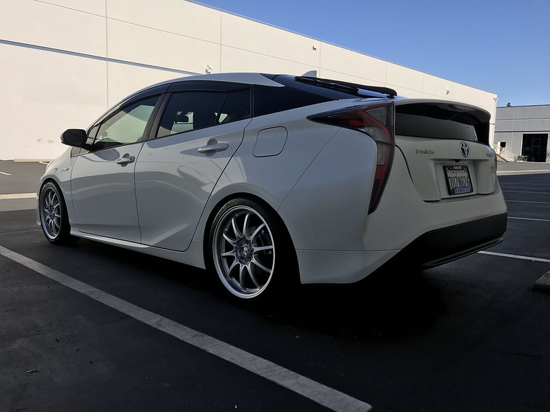

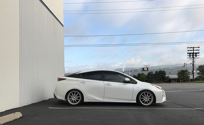

    I have the Megan Racing EZ II Series coilovers installed. Have it pretty maxed out and the ride is still comfortable. IMG_1283.JPG

    Clean wheels. What size are they?

    18x7

    Sick, man I like how they look but I don't think I can go 18's hahaha.. super clean man!!
