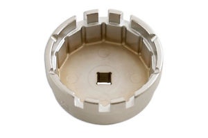

    I found out today that the wrench the dealer sells won't work on my 2013 Prius. I attached a picture of a similar looking one. It fits properly onto the oil filter housing if it's off the car, but there's not enough space to fit it on when the filter is installed. Any ideas on a wrench that will work?

    Any regular 64 mm 14 face socket will work fine. It's that extra portion with the irregular slots that's interfering, I think.
    I'm using the Honda oil filter socket, fwiw.

    Does the official Toyota one have notches? If so, what's their function?

    Yes. There are 3 tabs on the oil filter housing that 3 of the 6 notches line up with. That wrench fits the housing perfectly if the housing is out of the car. The problem is there's not enough space to get that wrench onto the housing when the housing is installed, at least with the '13. Maybe in previous years there was more space.

    Something doesn't sound right. The housing is part# 15620-37010 and is used from 2009 up to 2014 and fits several models.
