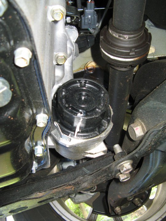

    All of Europe has banned the metal screw and spin on canister of yesteryear for environmental reasons.
    Early into my Prius ownership, I purchased an OER or Original Equipment Replacement cap from Toyota for security purposes.
    To me, although expensive, the Toyota supplied wrench is worth it, if it avoids damage to the filter cap which can be had for $35 plus.
    When I got the car NEW, I marked the filter housing with a paint marker to verify the angular torque position of the housing, when it is properly tightened.
    I did this, before I did my first oil change and before I took the car to the dealer for the 10k oil change. The dealer service tech commented that he liked my idea of marking the position of the properly tightened housing. The marked was correctly positioned, when I checked the housing.
    The housing is marked >PA6T/XT-GF35<. PA6 is polyamide or nylon 6. G means that the plastic is impregnated with glass fibers of fiberglass. The second part after the / mark appears to be proprietary to the subcontractor that manufactured the part. Possibly, "GF" means "glass fiber." It's one tough heat resistant material.
    If properly used, there should be no issues with the cap. After "breaking loose" with the cap wrench, remove it by hand and clean it carefully but NOT in solvent.
    When replacing it, hand start it and run it down by hand. Tighten it carefully to the original mark or the specified torque.
    That's all there is to it.

    You are correct - GF means glass fiber, and the 35 indicates that it is 35% glass fiber loading into the Nylon. Very tough and durable. I used a pliers-style filter wrench on mine without issue, but i did scratch it up a bit. Will probably invest in a proper one for the next oil change.
