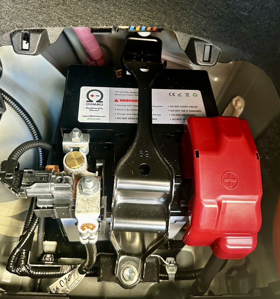

    Here's an OHMU battery install in a Prius Prime pic.

    Have you been monitoring its voltage with a BM2? An LFP battery might be running at a very low SOC because I doubt the car’s BMS/DC–DC converter is compatible with it.
