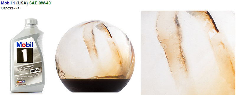

    True, however take a look at the picture in the attachment. This oil did much better than other oils, but it's not the best. I am starting to think that a good mineral/blend oil is actually what we may need. None of that PAO stuff that polymerizes on the pistons/rings. Conventional/blend oil usually does well on the heat test. PYB 10w30 with noack of 4.4% comes to mind, however it was not tested.

  11. orenji
    orenji Senior Member
    Aug 17, 2013
    5,887
    3,488
    Not clear on what I am looking at in the attached picture??

    Oil heated to the temperature between 250c and 380c to verify if it polymerizes and/or forms deposits. The link to the tests of various oils is in the first post.

    You can test your oil yourself using a spoon and a butane lighter. Sounds silly, but it seems to give some insight.
    Example

    Take a look here. Amsoil was tested and probably 0w20 has the same base oil.
    M1 doesn't do that great when tested.
