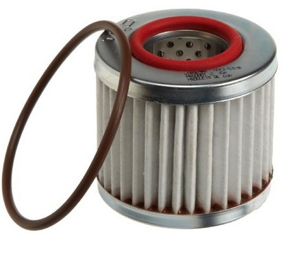

    I just changed my oil and when I pulled the canister off and took the filter out I went to wipe down the inside of the canister and saw a chunk of the filter on the bottom of the canister. It did not occur to me to take a picture at the time.... it was roughly 1 square cm. I had to fish it out with a screw driver before putting the new filter in.

    Obviously this is not normal. The oil may be able to last 10,000 miles or 1 year but the filter probably breaks down long before that. I am considering putting oil filter replacement on a 5,000 miles interval like regular cars. We all know it is possible to pull the canister off without draining the oil, there is minimal oil loss and just have to top it back up.
    Has anyone ever experienced a filter falling apart? Can the conditions cause this? Is 5k interval a good idea?

    Maybe try the Toyota TRD filters, they seem much more robust as compared to the stock filters.
    Part #: PTR43-52090

    I used the TRD filters the first 50K and have switched to using the Mobil 1 M1C-154 Extended Performance Oil Filter. About 20% or the TRD filters I received had quality issues with the construction of the filter and could not be used. Too high of a rejection rate to absorb. In my humble opinion, there are better filters than the OEM filter for a 10K service interval. I change oil/filter at 7.5K but I will not use the OEM filter.

    Did the filter media come from the current filter, or was it from a previously installed and removed filter?
    It could have been a scrap left over from the manufacturing process. Were the edges clean cut or was it raggedly torn?

    That's what I've used since my first 10k oil change interval. I haven't seen any quality issues in the TRD filters.

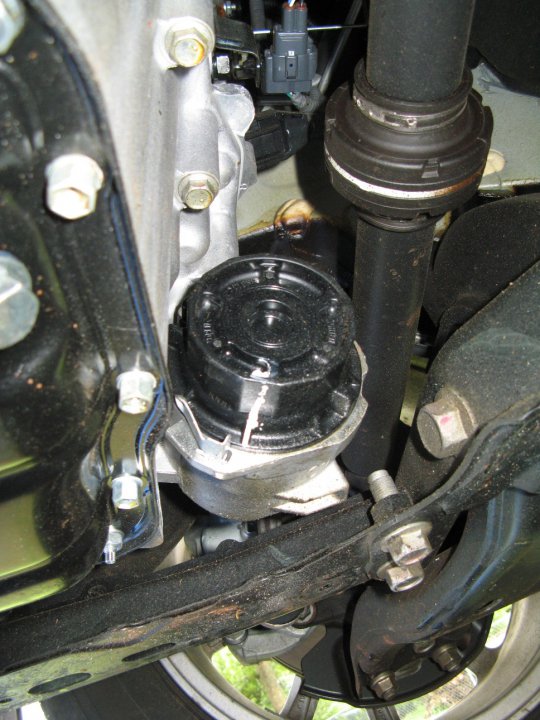

    28 ft lbs?? Correct torque is 18 ft lbs for the filter cap.
    I have not had any problems with a 10k interval on the filter. The filter has always looked perfect upon removal for me.

    Neither have I- yes they're hand stitched, so the seam may seem a bit irregular but it's 100% functional and way better made than the stock OEM filter especially with the metal endcaps.

    The metal end caps, apparently are "glued" to the ends with an exothermic setting epoxy, as are the OEM filters, so I don't see how they are any better.
    I'll stick with the OEM filters.
    Again, I still believe that the piece found by the OP was likely a cut-off scrap and NOT part of the functional filter.

    it is 18 ft lbs
    mistype, I accidentally gave oil plug numbers but meant 18 on original post

    I just mark the housing in relation to the "clip," before the first oil change.
    The dealer did three complete oil changes and always returned the housing mark to within 1/8 inch of the clip.
