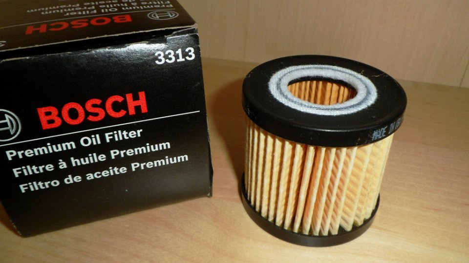

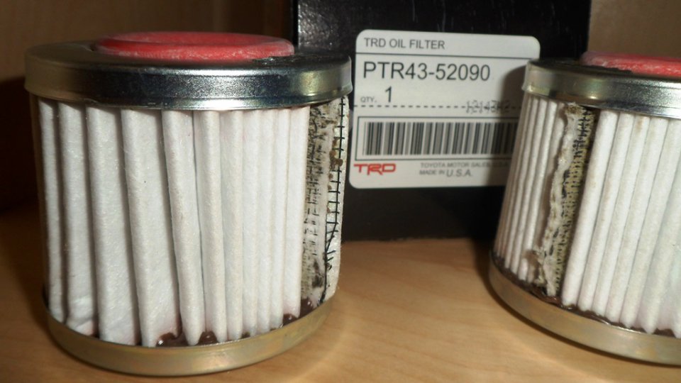

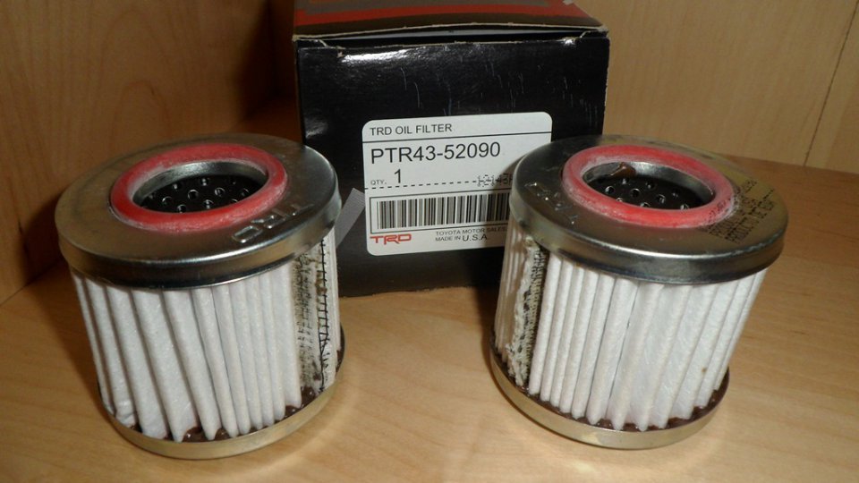

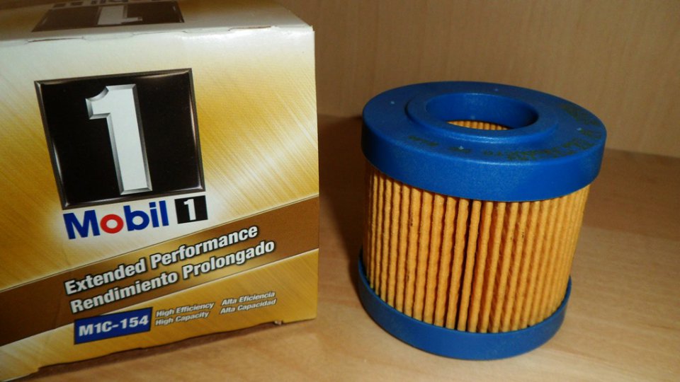

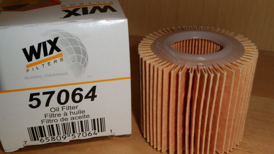

    Pictures may better explain issues I've seen with the TRD filters. Also added a few other brands to compare against. Weakest link in a 10K oil change is the filter.

    Looking at the Wix filter I do not see how that works. The pleats in the filer material are open ended giving a direct non filtered passage for the oil flow.

    That's normal for the Toyota TRD filter- they're hand stitched together- each filter is unique.
    If you look closely at the Toyota TRD filter- you'll notice it has a perforated metal interior core also- none of the other filters have that or the metal endcaps...

    Sorry. I don't buy the "each (TRD) filter is unique". Even if this is only a cosmetic defect, it's a defect none the less. Zero excuse for these ever being OK'd to ship. These are made in the USA. We can do better.

    If you look at the Wix filter the ends of the pleats are not sealed making a strait unfiltered path at this point for the oil to go through. All the other filters have end plates bonded over the end of the pleats.
    There also seems to be an assumption in other threads that the filer is before the oil pump The pump drawing oil through the filter. This is not the case, the pump works in unfiltered oil pushing it through the filter.

    It's not a "defect" that's just how they are made.
    Have you ever bought an article of clothing with the tag "this garment is hand made (or hand dyed, hand stitched, etc...) and each is unique- slight differences in appearances should not be considered a defect...."? The TRD filters are stitched by a human using a sewing machine- not a robot assembly line.... each filter will look unique. I've purchased 6 TRD filters since 2012- every single one looks different from the other TRD filter... that's just how it is. Just by construction alone (metal endcaps, metal center, etc...) the TRD filter seems like a better filter than the others shown above. None of the TRD filters I've used have separated at the seams once removed from 5-10k of service.

    The problem I see "unless I am missing something" is at the end of the filter outside of the white seal ring on the filter is what appear to be open pleat ends.
    Where on the outside diameter you have a fold on the inside diameter it is open, having a fold to either side. The end of the pleats cannot reasonably seal even against a flat plate. This gives a clear passage to oil in whatever direction the oil flows. I will take the top picture and try to arrow my area of concern to make it clearer tomorrow as it is very late here now.
