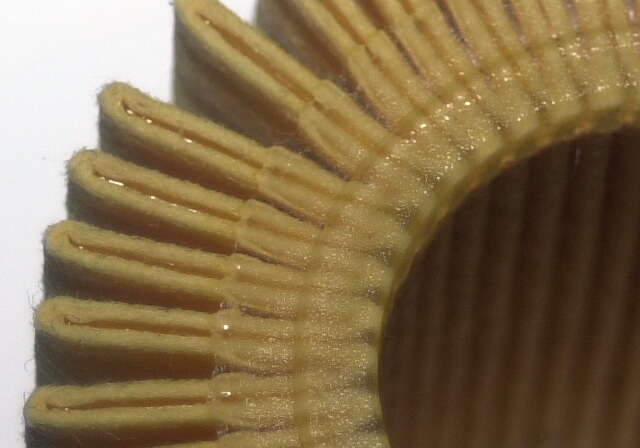

    I took this photo of the factory filter I have out in the garage. The ends of the pleats are sealed with glue.

    Thanks, I thought I must be missing something, but this is not at all obvious in picture 1.
