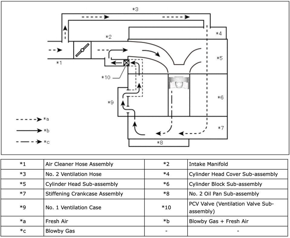

    In the Gen III Prius, an oil catch can definitely prolonged engine life, because it traps oil which would otherwise be drawn into the engine's intake. Because the Prius is direct-injected, this oil is not washed off by the gasoline and the intake and valves get coated with oil. The oil burns in the combustion chamber, and it then gets blown into the catalytic converter and into the EGR, where it can foul the EGR cooler and EGR valve.
    With our 2026 Prius about to arrive, I wanted to know if anyone's installed an OCC on theirs.
    At first, I thought the PCV was the big hose on top of the engine, leading into the air intake. But then I checked the service manual, and found that it routes into the throttle body. It is Item 10 in the picture below, and not *3, which I had first thought.
    #1 Rebound, Jul 24, 2025

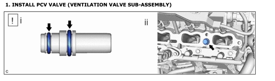

    Update: It appears impossible to install an oil catch can on this engine. The PCV valve vents directly into the intake manifold, without any hose whatsoever. To access the PCV valve, you must remove the intake manifold.

    Personal oil catch can use. Outback has one case it is direct injected. Had one on the 2000 Ranger cause the old Vulcan 3L had known carbon build up and dieseling issues. The new Duratec in the 2001 Sable should have had one. The line from the PCV value and intake manifold was really short; could see an oil film in there.
    In general, an oil catch can could be a good idea. Assuming there is place for it, and the additional maintenance isn't a hassle. Thinking on remounting the Outback's now for the latter.
    Not familiar with other designs, but there is some baffle system before the PCV valve in the crankcase. That could reduce oil getting to the intake by condensing oil mist out.

    But the Gen III still had substantial problems caused by the PCV delivering oil into the air intake. Even with port injection cleaning off the intake valves, you still get burnt oil in the exhaust, which leads to a clogged EGR and damage to the catalytic converter. This lead to head gasket failures on the Gen III.
    With this engine, we will need to remove the intake manifold periodically to inspect for oil build up. Or, perhaps we can remove the EGR pipe to inspect for oil deposits. I don’t have the car yet, so I haven’t been able to assess what’s needed, if anything.

    Yes, the PCV sits much higher than it did on the Gen III engine, which is a big improvement. In a Gen III Prius, it was standard to see about two tablespoons of oil pooled beneath the throttle body, on any model. We will need other inspection and remediation measures, like EGR cleaning, if oil gets through the PCV.
