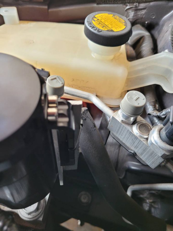

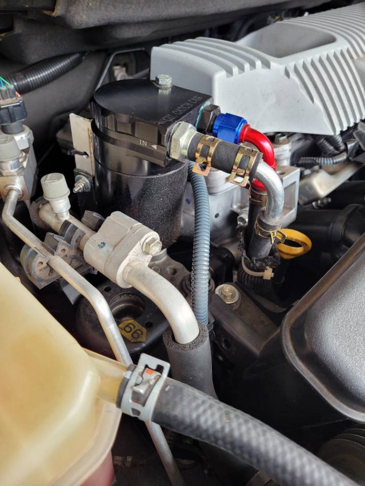

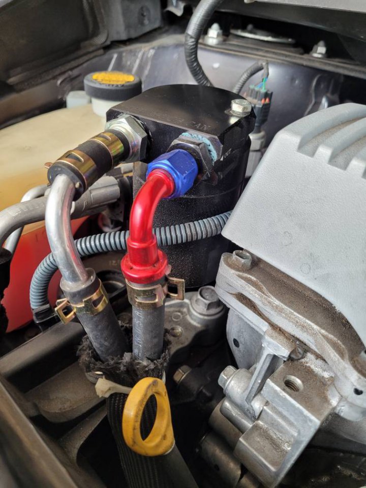

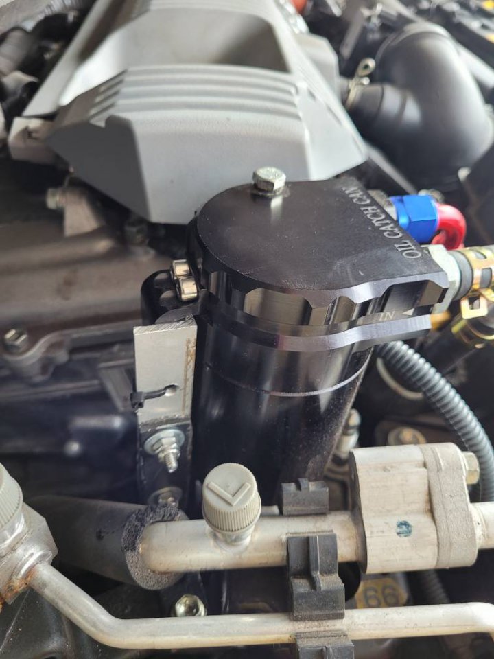

    I've relocated my PCV valve to the catch can, it's on a hose from the original PCV valve location that's about 24 inches long.
    Sorry, I don't have any pics of the 180 degree 16 x 1 AN6(?) fitting I replaced the original PCV valve with at the engine block. It looks like the red one on the oil catch can, but instead of a 90 degree tube, it has a 180 degree u-tube on it because I need to reverse the direction of the hose to get to my selected OCC location next to the coolant reservoir.
    https://r.tapatalk.com/shareLink/topic?url=https://priuschat.com/threads/do-i-really-need-oil-catch-can-occ-in-2012-prius.244896/#post-3405555&share_tid=244896&share_pid=3405555&share_fid=1171&share_type=t&link_source=app
    A few more pics showing that I moved the PCV valve to the input (labeled out on the OCC), and more detail of the mount. [​IMG][​IMG][​IMG][​IMG]<br /><br />Posted via the PriusChat mobile app.
    SM-G781V ?
    Mendel Leisk and doctorman like this.
