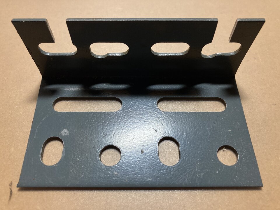

    This is a high grade aluminum bracket that was cut from a square aluminum piece. Due to tariff Prices going up this is the lowest that they can offer.
    Can you post a picture of your 3d printed bracket that was installed 7 years ago? Just curious to see if the plastic mount did not get warped from all the heat from the engine bay.

    :ROFLMAO::ROFLMAO::ROFLMAO: Yeah it’s not warped from the heat, it’s just dry. I’m sure that aluminum piece is of high quality, but the 3d printed piece is still good after all this time. I’ll take a picture of it when I do my next oil change.

  11. ASRDogman
    ASRDogman Senior Member
    May 29, 2018
    8,067
    4,089
    Less than $1 to 3d print it. And they make different types of filament that will hold up against
    the heat.
    And where it's placed, you have cooler air blowing over it....

    It’s appropriate for one particular location.
    I chose another location, mounted atop lower cross beam. This is the first, for single can:
    I subsequently went to 2 cans, similar bracket wider upstanding leg obviously. You can just see it:
    for anyone considering this: that beam flexes when the front jacking point is used, so you want a compressible gasket between bracket and beam.
