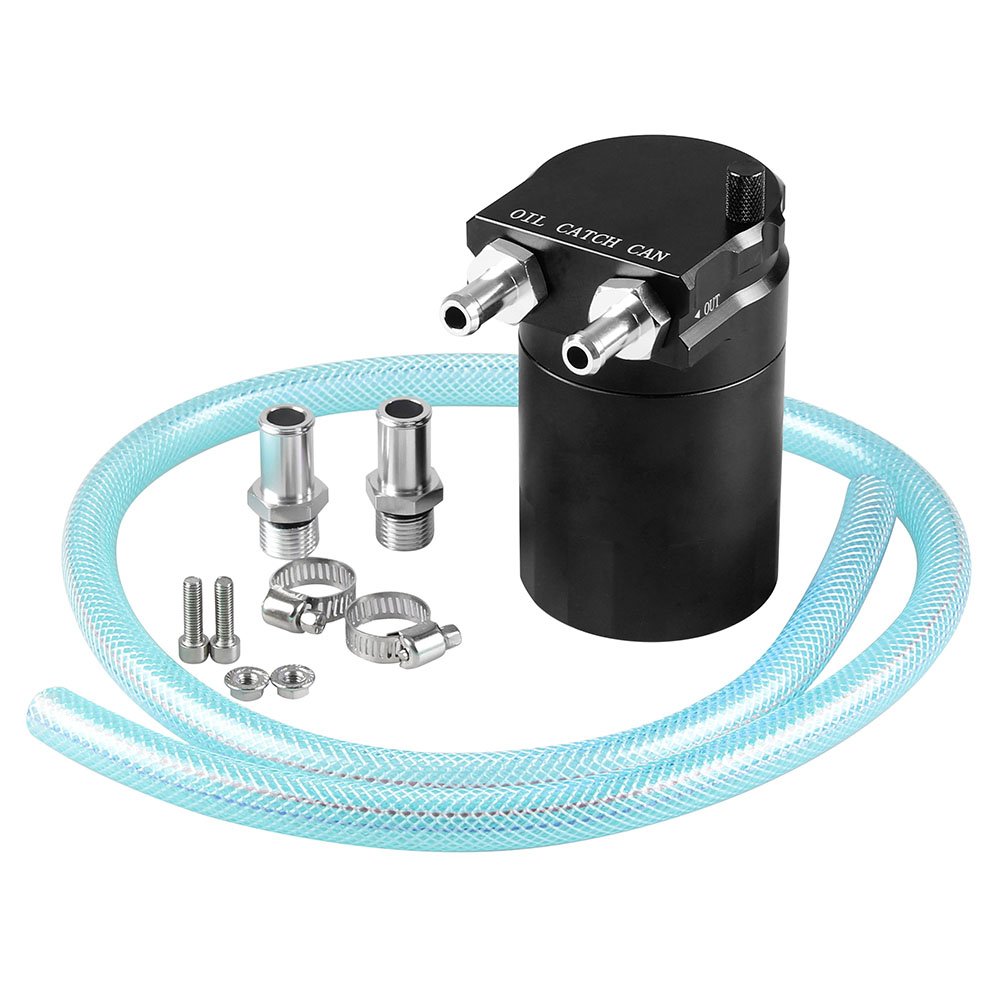

    what catch can did you buy exactly? were the hose connectors included?

    Clamps are included. I only used 1, everything fit nice and tight.
    previous pics show pcv and hose cut in half to use 3/8 coupling.
    3/8 hose and coupling can be found @ lowes/homedepot
    3/8 coupling
    3/8 braided tubing

    That OCC you linked is vented. Is that the one you bought? Can you seal off the vent?

    there's one without the breather

    I guess "airplane" style clamps are ok with steel spigots? The spring steel ones (like OEM) are maybe hard to find, in particular the right size? (n)
    So you basically splice this in, in "series", on the hose connected to the PCV valve? And position it to be accessible, for dumping, without need to disconnect?
    Why braided clear plastic tubing, as opposed to black rubber vacuum lines? To more easily monitor? Oil will break the latter down?
