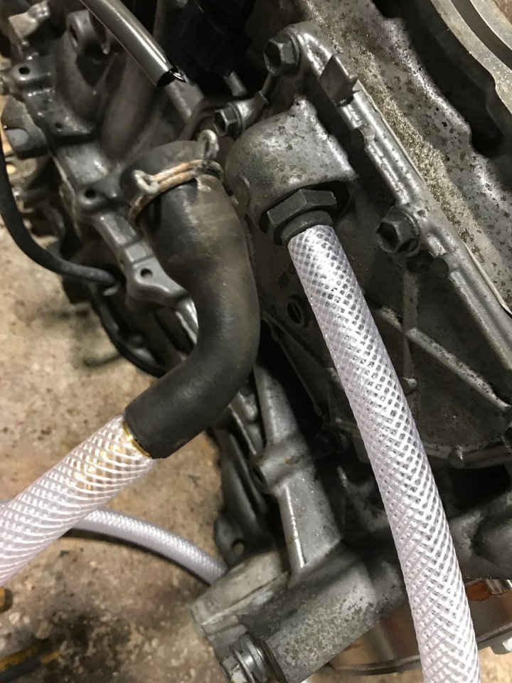

    Sorry to chime in late here. I have been having some knocking problems and acceleration problems and it just felt like there was something wrong with the air intake. Saturday morning I took apart the throttle body, intake, air box, etc. to figure out where the problem existed. After removing the throttle body I noticed right away there was a nice puddle of oil in the bottom of the intake. I traced the leak back to the PCV valve, which I had recently replaced so I figured it was good. After some online search I found this thread and decided to make the oil catch can.
    To answer some questions; yes, remove the intake to make the oil catch can! Picture below shows you have no room to work from underneath the vehicle, plus you have to take off the annoying plastic cover. Picture from underside of car: P_20170604_150319_vHDR_Auto.jpg
    Removing the intake is four bolts, plus some hoses, electrical connections, and the EGR pipe. I think I took the most time at Home Deport finding the parts! I used 3/8" braided clear hose, a 3/8" brass male to male connector (to connect new hose with cut in half old PCV hose), (2) 3/8" to 1/2" 90 degree connectors for connection to Ball jar, (2) 1/2" threaded PVC nuts (to secure 90 degree connector to jar lid), some steel wool I had laying around, and a Quart size wide mouth Ball jar. In all, the supplies cost about $30, but of that $30 I spent $11 on a 12 pack of Ball jars.
    So far the car has run much better, in my daily commute with heavy traffic on I4 in Orlando, I have not noticed the knock that always use to be there, and the car accelerated much better. Overall, I would highly recommend this mod for anyone having similar issues! Next up, cleaning the entire EGR system, anyone have suggestions for that??
    Robert Holt, danlatu and kc410 like this.
  12. Mendel Leisk
    61,514
    42,326
    That picture's from below?
    Meh, I would try from the underside still. I take off that "annoying" engine underpanel every 6 months, with oil changes, no big deal. I appreciate it's tight quarters either way, but it seems a lot less disruptive from below, compared to removing crucial engine components from above. Again, @NutzAboutBolts video removing the PCV valve is from below.

    Yes, that's a picture from below.
    I'd still recommend removing the intake just to clean out all the build up. I used an entire can of throttle body/intake cleaner on those parts and there is still some build up left.
    Good luck!
