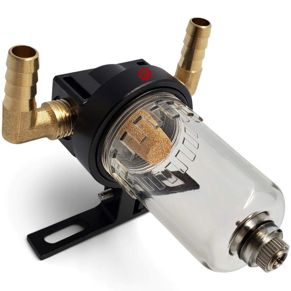

    One thing I was hoping for is a clear catch cylinder like the many smaller ones I see around.
    Is there any disadvantage to using something like this?

    Where are the most commons spots for the OCC?
    I'm hoping my slightly smaller option will give me a bit more flexibility to shorten the hose lengths.

    I'm thinking of mount my smaller OCC to the right side of the engine cover. Easy to see, easy to get to, more direct line of flow for the tubing (no hard bends). Will post pics when its done.
