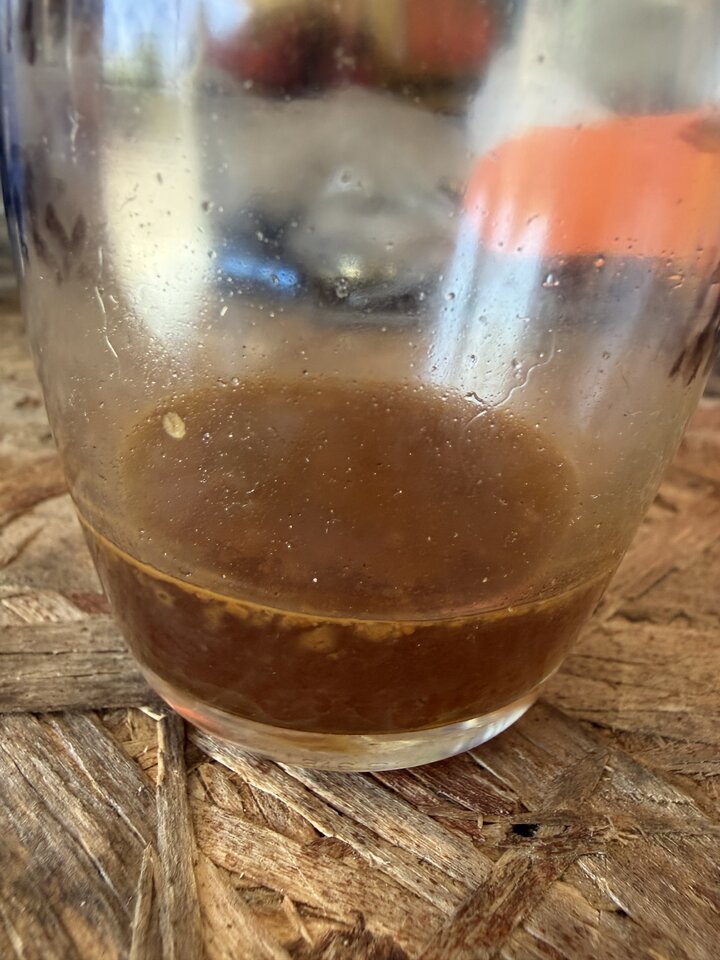

    Just did the 150k mile oil change and here's what the oil catch can caught:):
    About an ounce of watery consistency :eek:.
    Glad the catch can is there (y).
