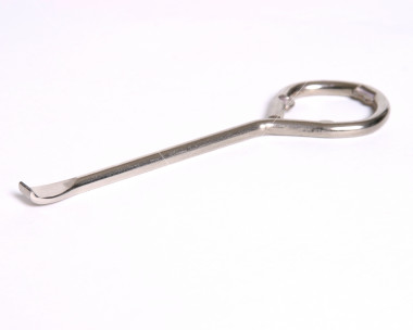

    Spare fasteners are a good idea. For those fasteners I find a paint can opener like this very handy, due to the right angle hook:
