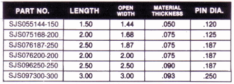

    I have been considering using one or two of what are called slip-joint hinges, such as the ones below. They should secure the door and allow it to swing and be removed.
    Thoughts and comments?

    The hinges seem a good idea too: point all the pins the same direction, use two or three shorter hinges with a slight gap between each. That way the door can be swung down and/or pulled completely off, once the 3 retaining pins are out. Especially good for people just using low-lift ramps who don't have much clearance.
