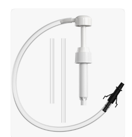

    I took my 2018 Prius Prime Adv in for routine oil change at 46,213 miles and they said that the transmission fluid should be changed at $269.00. I passed at the time since I was in a hurry but today I take in in for routine wheel rotation and balance and the Service Advisor told me I need the injectors cleaned, brake fluid changed and A/C condenser cleaned and inverter fluid changed. The inverter is supposed to be changed at 60,00 miles I find on the internet.
    I asked him about the transmission fluid since I was contemplating a change and he said, 60,000 miles vs the previous visit that indicated it was in need of changing. This leads me to believe that some dealers push various services that are really unnecessary or in some cases premature. I have an in-ground storm shelter in my garage that I can drive the car over, crawl into the shelter and the car is level and I can do my own trans fluid change and that precisely is what I am considering at this time.

    Changing the transaxle fluid yourself is definitely doable, and would save you probably over $200. A couple caveats/considerations.
    • Review which plugs on the transaxle do what. The coolant drain plug is in a similar location, so if you're not wanting to change both, look to which one does what.
    • For my car, I'd just use the ATF-WS, or the newer transaxle fluid, depending on what's recommended for your Prius type and year. These are available from the dealer's parts department. I wouldn't go for any aftermarket brand.
    • Remove the fill plug first. This makes it so you don't get the drain plug out, but can't get the fill plug out. If my failing memory, and the fact that I've done this on a Gen 2 and Gen 3, but not a Gen 4 or Gen 5 is correct, the plugs are for a 10 mm allen hex bit socket (use a good one). If your allen socket, or the hex features in the plug round off, you can take it to the dealer. If you pull the drain plug, but then can't get the fill plug out...
    • Stop by the hardware store, and pick up about 3' of tubing (take your fill plug to the hardware store so you can get tubing that's just a little smaller than the fill hole) a funnel (and maybe some duct tape to hold the two together). Alternately, the auto parts store has a hand pump for a quart bottle. The fill plug isn't located where you can pour the fluid into it. The only way to get the new fluid in is to thread the tubing in from the top (or pump it up from the bottom).

    . I bought a pump such as this: Untitled 2.png and bought ATF-WS fluid for the change and already have the 10mm allen hex wrench/socket.. I appreciate you telling me about the coolant drain plug. I'll pay particular attention to that.
