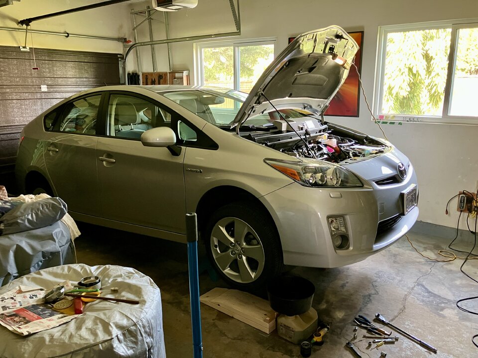

    Performed the 3rd Valvoline Restore and Protect oil change today. Our driveway has a little slope and previously the car was pointed downhill so that it would be only slightly tilted uphill once the jacks were in.
    Today I brain farted and parked the car in the other direction.
    The oil was about 2/3 low on the dipstick, or roughly 1 qt. low, so should have held 2.9 qts.
    Drained it "all", replaced the filter, buttoned up the bottom, and poured in ~3.5 quarts. Took it off the jack stands, drove it around for about a minute, put it back in the same position nose up orientation but wheels on the ground, checked the oil. It was about 1/4 of the distance between the dots high. Grabbed a ruler: 43 mm dot to dot, oil is 10 mm above top dot. 1.6 qts between those dots, so about 0.4 qts high.
    Dumped all the waste oil from the drain pan into an empty 5 qt oil container. It came to almost exactly 2.5 qt. (Although reading through the side of the VRP container is difficult, the "clear" part is not very clear.) Apparently with the nose up that much .4 qts remained in the motor. That would explain the oil color, which was "very slightly dirty", consistent with 10% old oil in 90% new.
    But that can't be quite right either, or it would have been perfect at 3.9 qts. I must also have underestimated the volume added. Next time I'm going to use a measuring cup where I can clearly see the amount.

    The oil pan geometry is a little peculiar. To drain fully the car must either be perfectly level in all directions, or maybe tilted a small amount side to side with the drain bolt down. Toyota designers probably assume all oil changes would be done in a shop, where level is the default, not in a driveway, where it isn't.
    Now that I think about it, I usually also move all the other cars off the driveway and center this one. Didn't do that this time. The driveway is slightly "U" shaped and the passenger side was close to an edge, so slightly uphill in that direction too.

    FYI: gen 3 oil pan has the drain bolt at the rear edge of oil pan, much more sensible. Last oil change I did, with just the front raised as usual, and quite high, I let it drip for several hours (had dinner), and when I checked it a few days post-change, it was a solid 500 cc below top mark. Third gen oil change spec is 4.2 liter (with filter change), and 4.7 liter dry fill. Guess I got it near-completely drained:
